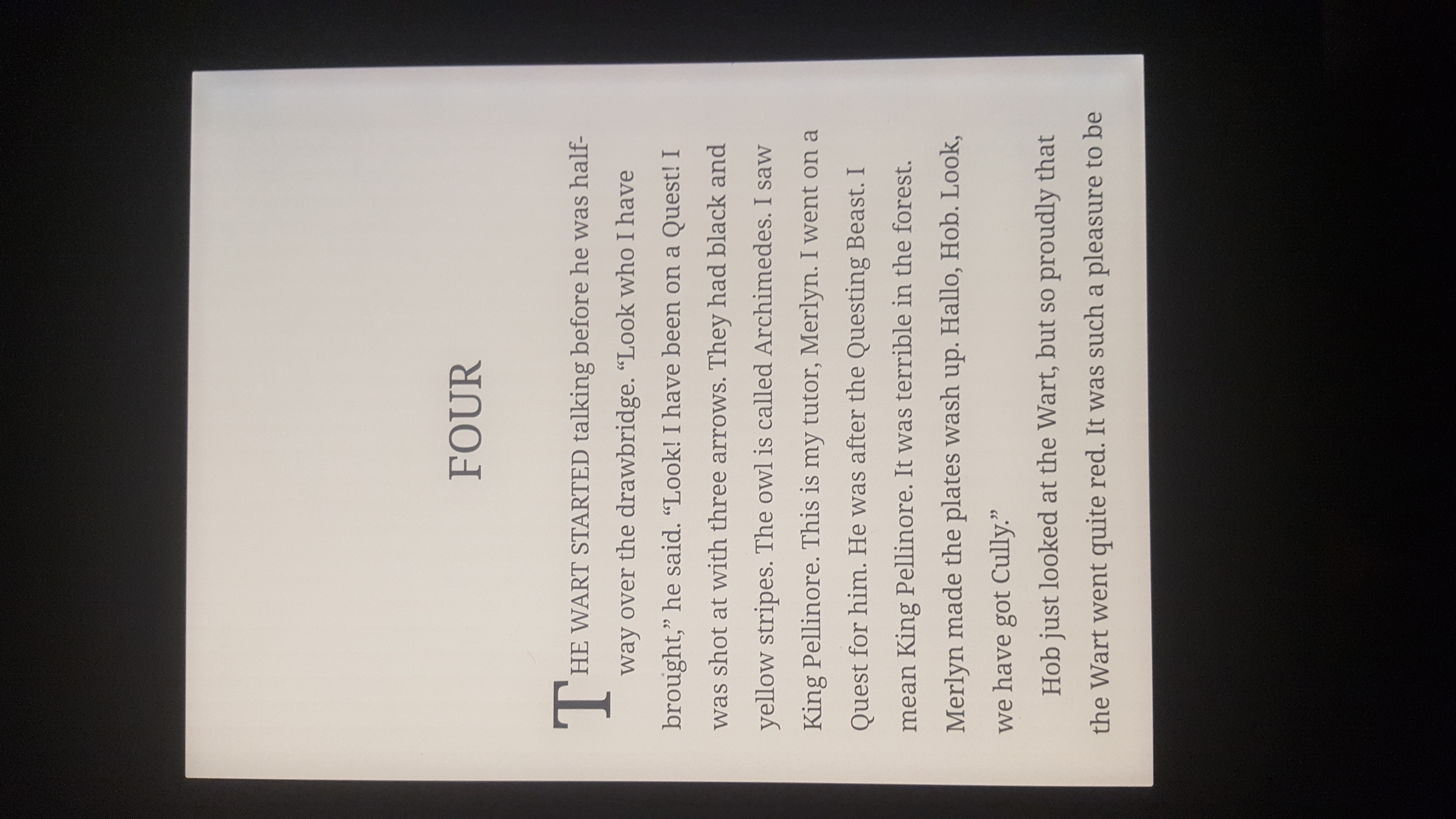

I'm curious how many Forma owners experienced the wedge-side light issue like I did where there is a band of lighter blue light and some grey shadowing. The intensity varies based on natural light and the brightness and comfort light settings.
I'm also curious if folks are entering the "panel-lottery" in seeking a replacement, living with it, or just getting a refund.
Click for a full-size image

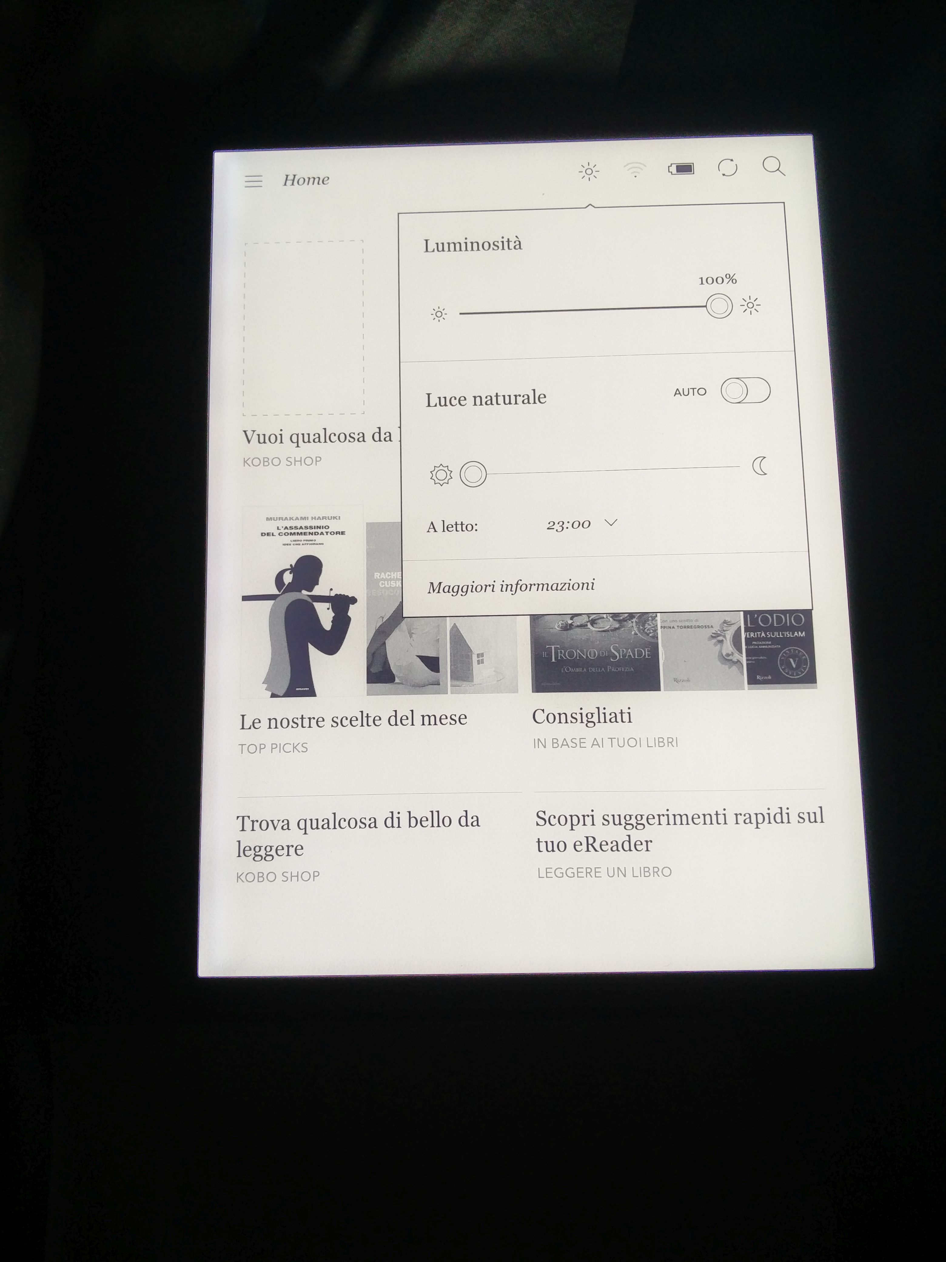

I've just sent the e-mail asking for a replacement unit. I tried the KA1 in a market yesterday and I didn't like the added weight. Also I LOVE the Forma's handle, it's just so comfortable. That just convinced me I need to get a working Forma instead of a new KA1.
I would like to ask everyone saying they have no light issue: could you take a picture of the device with 100% white light on in a dark room? Not because I don't believe you, it's just we haven't seen one totally functioning device yet.
This is mine, light issue on the left side:
