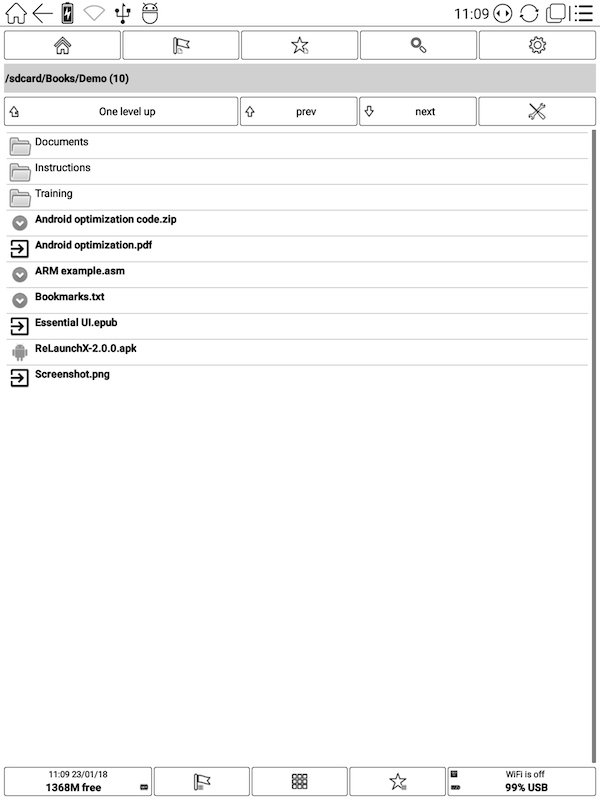

I can't figure out how to use this as a launcher. I don't want a file manager, but I thought you were able to use this as a launcher. I just got a Likebook Mars and wanted to try it again. In advanced options I have it set to use as a launcher when I tap the home button, but it still opens as a file manager. The advanced options also let it open as a launcher for the library button or shop button, but I don't see either of those buttons. I have work mode set to use advanced settings.
Does anyone know how to do this?

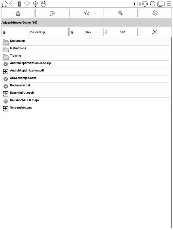

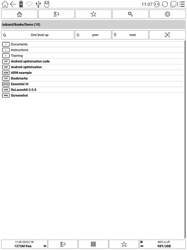

I asked the same question back in post 122
Originally Posted by plusz View Post
Originally Posted by DoctorOhh View Post
I'm a little confused. Is it possible to launch existing installed apps like Calibre Companion or Moon+Reader from this APK?
Of course it is possible.
The app can work in two modes:
- books manager only (picture 3)
- launcher and books manager (picture 1 and 2)
To have the bottom toolbar, where the app launcher, task manager, etc. functions are accessible you need to make your tablet use ReLaunchX as a launcher. Displaying the launcher toolbar all the time despite the work mode would be very confusing. When you have a different launcher active in the system you fall back to it whenever you press the device home button, exit from apps, etc.
For most devices it is as simple as to choose ReLaunchX when the device boots or when you press device home button after installing ReLaunchX, on other devices it may be tricky, possibly via device settings or eventually only through rooting.
ReLaunchX 2 as a launcher, default view
Attachment 161761
ReLaunchX 2 as a launcher, icons view
Attachment 161762
ReLaunchX 2 as a book manager only
Attachment 161763

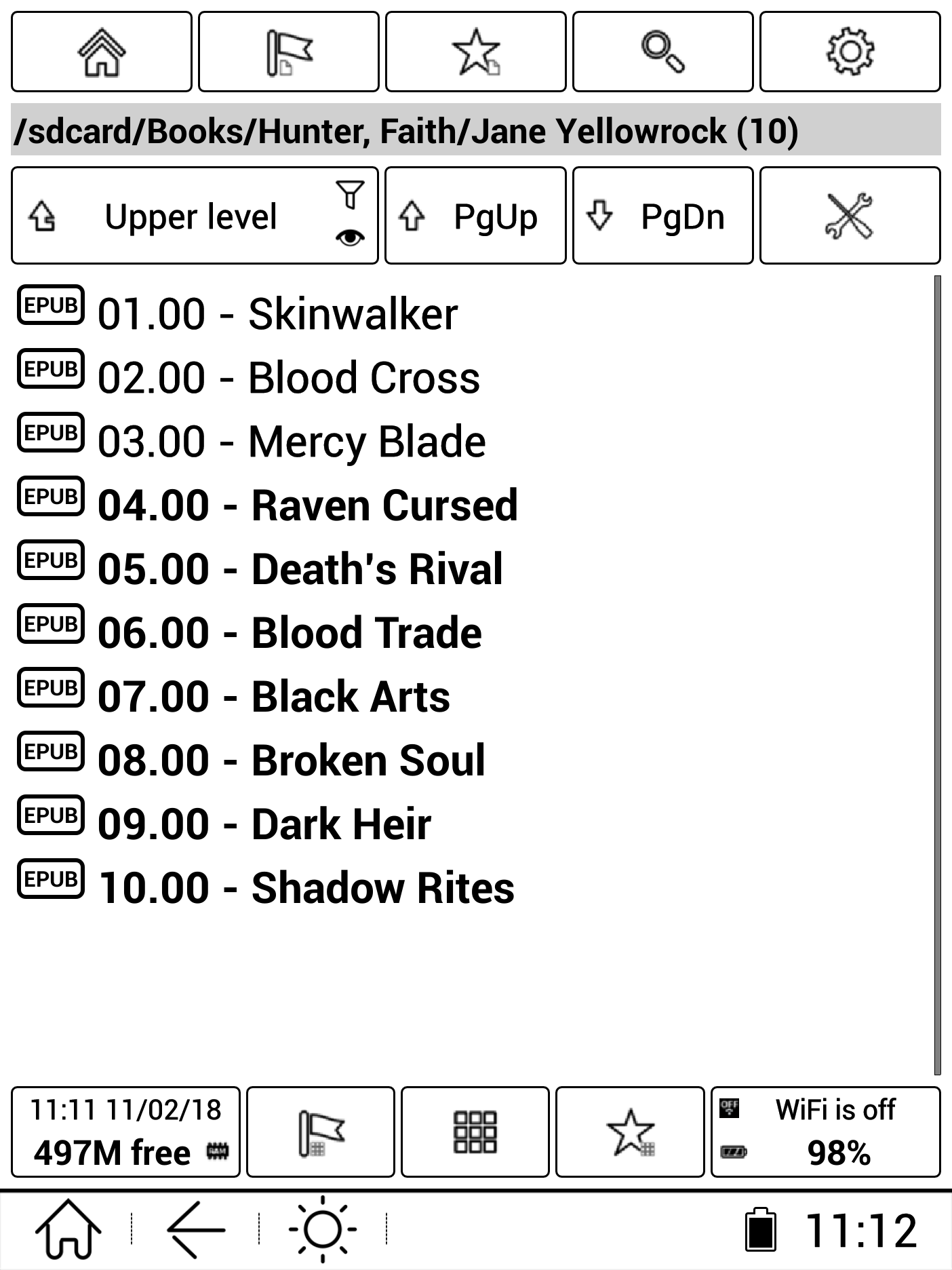

Thank you. I never noticed the bottom row before.
I attached what my setup looks like. The bottom center icon is All installed Apps, to the right of center is favorite apps and to the left of center are last used apps. You may have to go into settings to choose RelaunchX as your launcher.
By default it always starts to the file browser. This works for me since my main use is reading I use it to launch my books in Moon+ Reader Pro.
I don't have a bottom row of icons, and I thought I remembered something like that. What version are you using? I downloaded 2.1.2 from the first post.
Apparently you won't see the bottom row unless you open it as a launcher. If you are currently using Nova, go to android Settings - Apps, choose Nova and clear defaults, then press the home button or home icon. This should give you a choice of launchers to use from those installed.
FYI I have 2.1.0
Thank you! I never would have figured that out. I was able to have Nova set as the default and use a home switcher app and change to relaunch.
