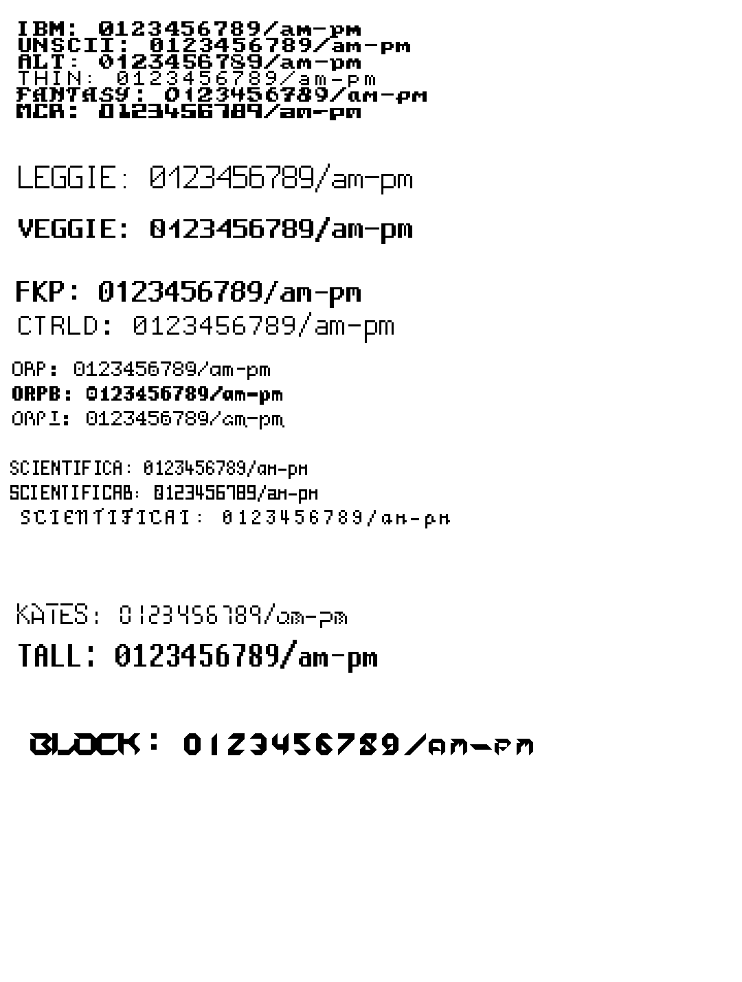

And while I'm there, here's how the various fonts look, in this context .
