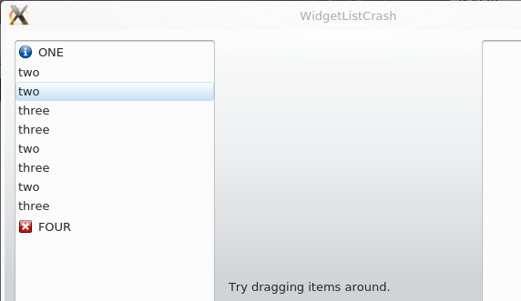

I compiled and ran WidgetListCrash on my Mageia system. It crashes when I move an item with an icon. It also duplicates the items when I drag items with no icons. See attached screen capture.

The duplication thing is expected. There's no copy/remove code implemented in the test. It's just simply illustrating the drag/drop crash and nothing else.
