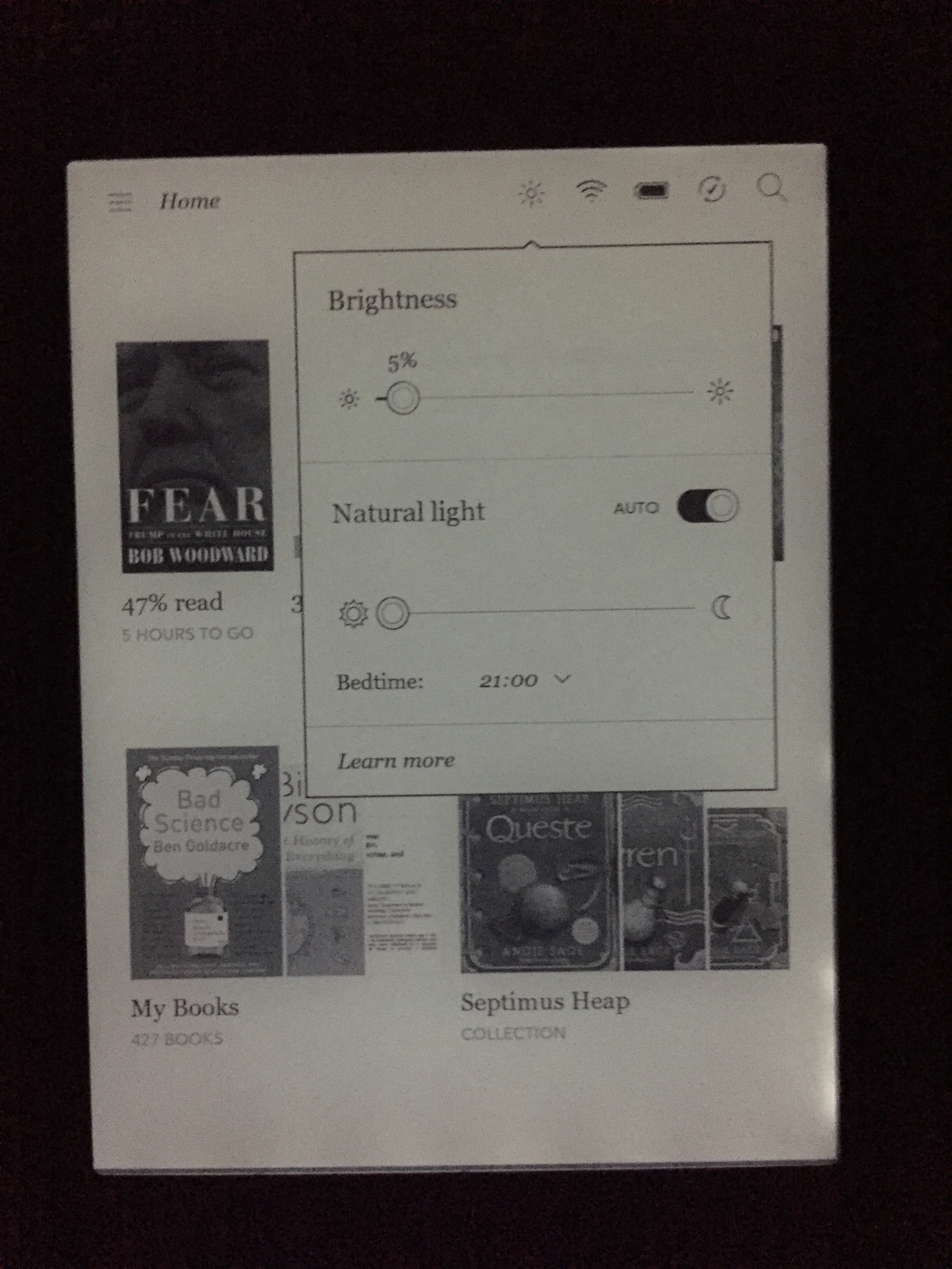

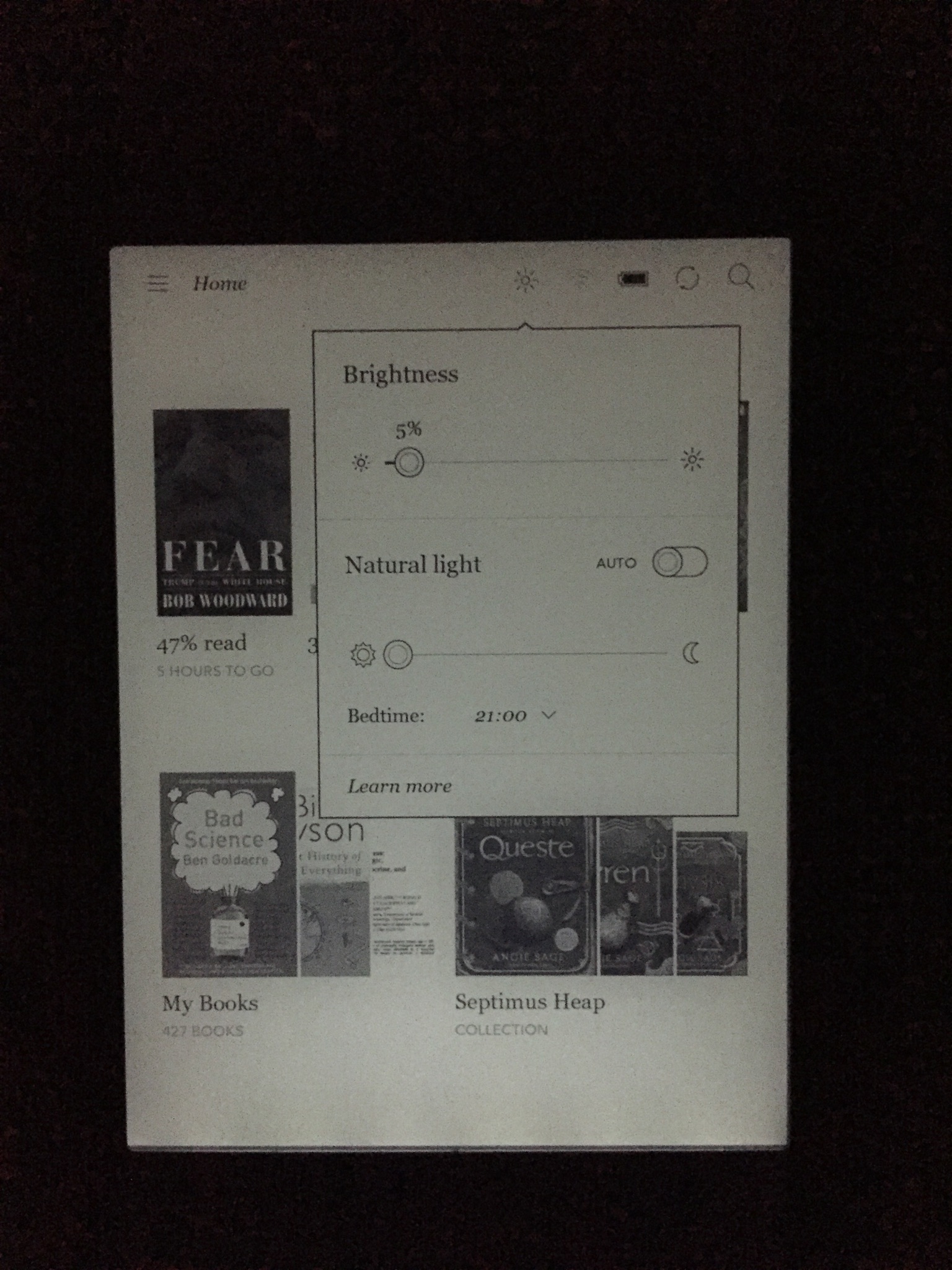

Atilla! You are my hero *again*!! My Clara's light bleed was annoying me more and more, and I too didn't like the idea of any extra thickness between the screen and the bezel (blackout or electrical tape), so I applied your black marker solution. OH MY! Now my Clara's screen is perfect. Thank you!
I haven't noticed any general darker lighting (yet), but if I do (when I read this evening when it's darker), I'd consider that an extra win!
Two before pics & two after pics attached.

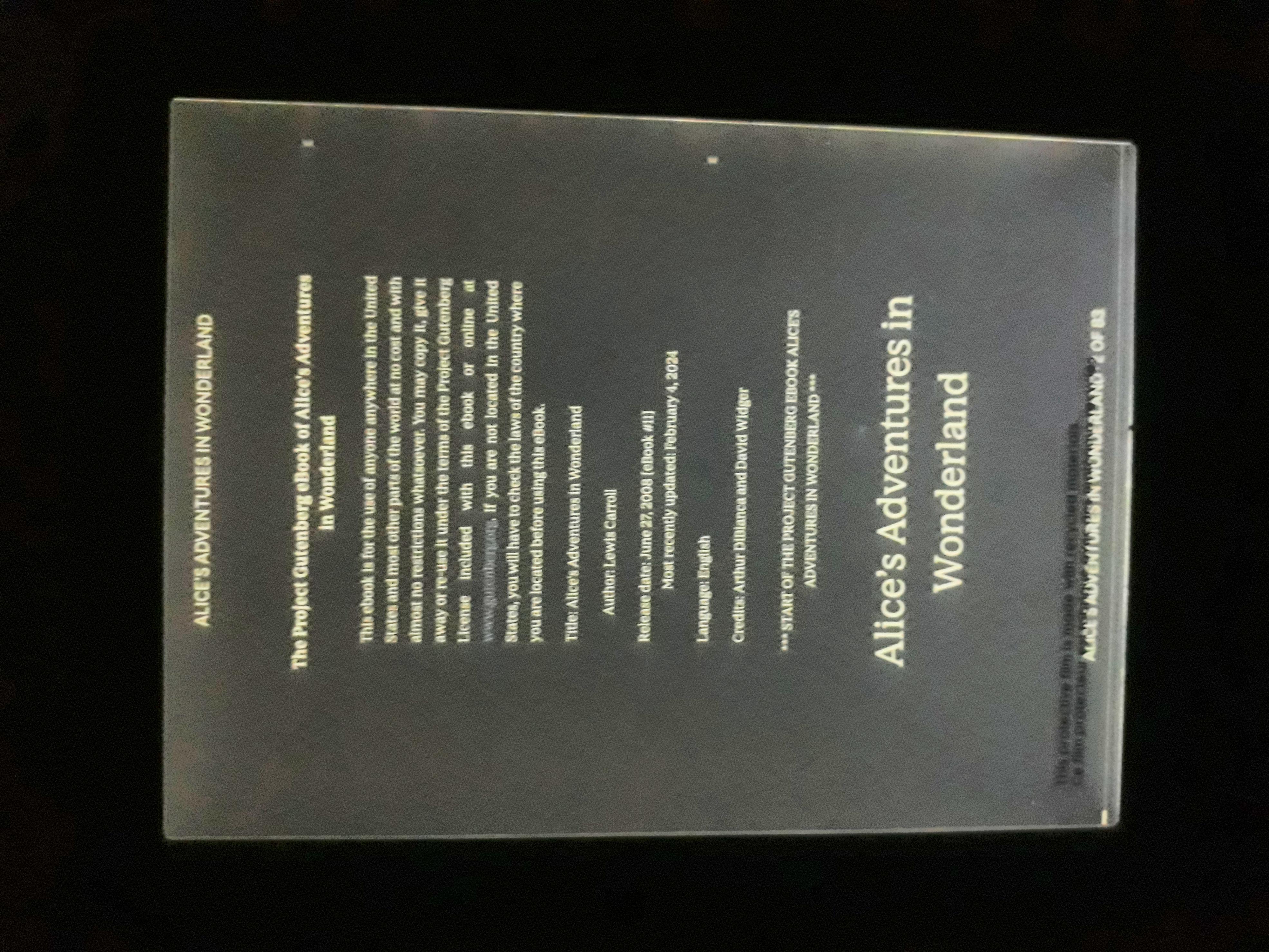

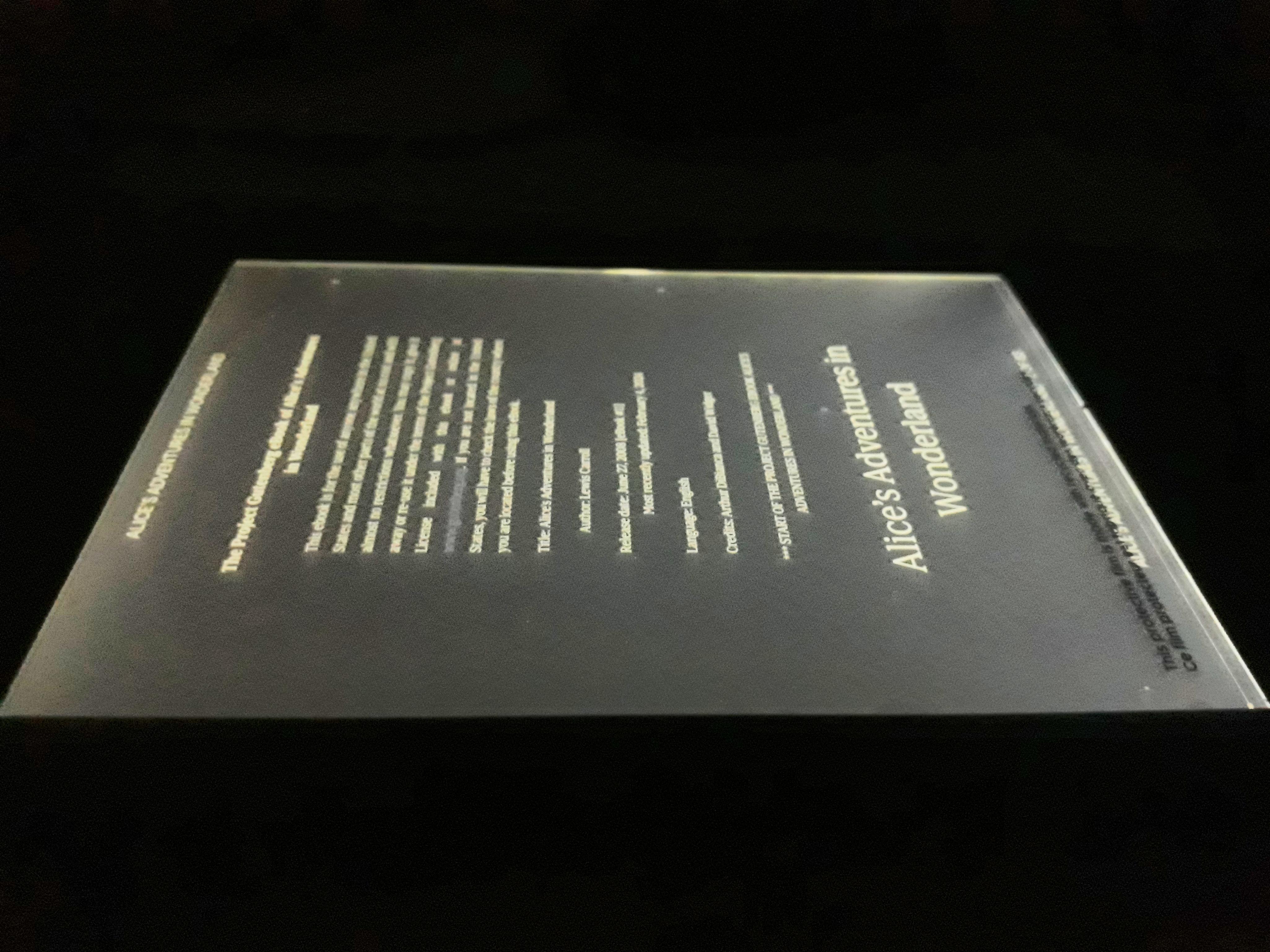

I'm on Kobo Clara Colour and looks like it has the same issue.
This is my 1st EInk device and recently purchased one. I got the return/refund option for few more days... What would you recommend? replace with another one or expect all device to have little bit of these bleed-light issues as there are leds in sides?
I don't think kobo fixed it in any of their models. Limitation of using E Ink devices?
