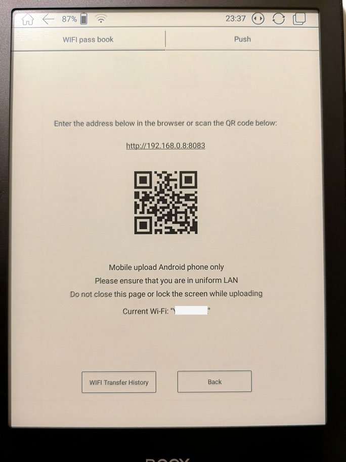

New feature in 2.0, built-in file transfer app, a HTTP server.
