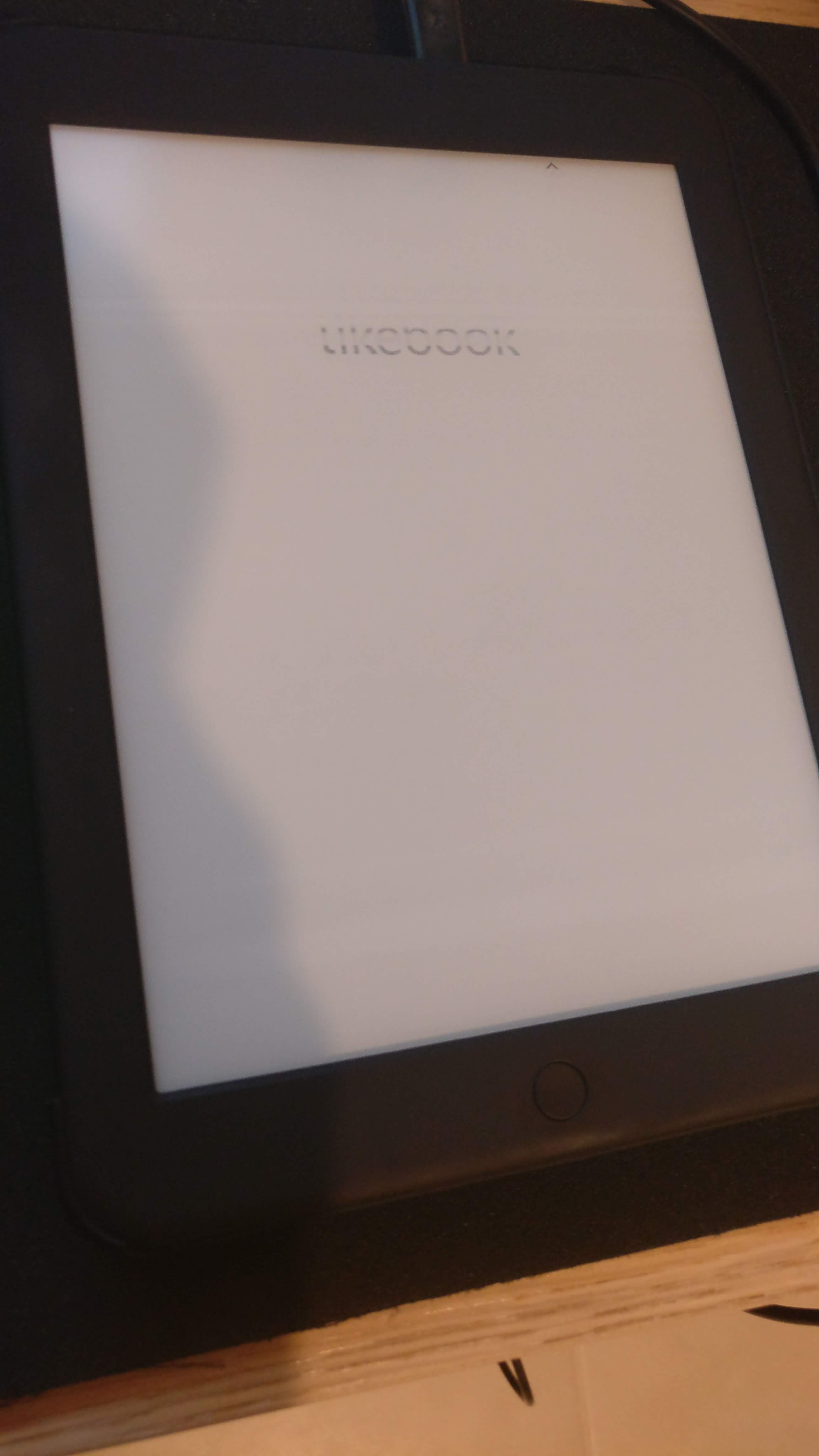

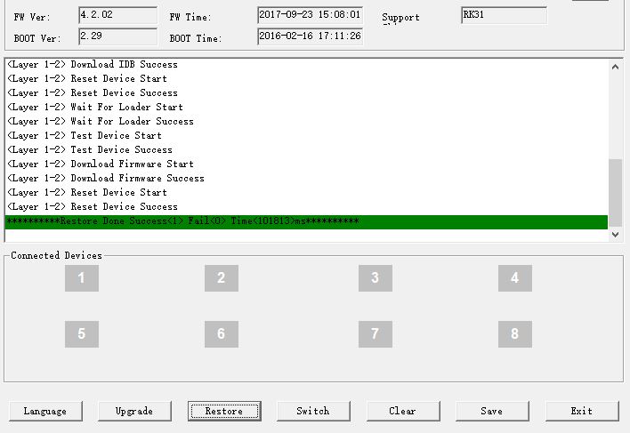

Originally Posted by arfok View Post
I try flash with RCB Tool with software update-Likebook-T80S-2018052616.img but it's not working. My ebook is still death.
Any advice?
What does it mean, that still dead?
My update process also went wrong. During the restore there was everything fine. See attached output. Restore Done Success (1) Fail(0)
I heard the windows sound of unplugging and plugging a device. Even I have an almost empty LIKEBOOK drive with 13.5GB of storage. The main problem is that the screen is completely dead. See attached photo.
Any ideas?
Has anyone the original 1.0.x firmwares in img format?
Thanks

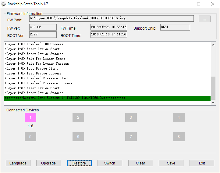

Any ideas?
Thanks
csonger
I have the same result - my screen is dead. I'm using RBT 1.8.
I'm try version 1.0.1 frimware but no success.
arfok is offline   Reply With Quote

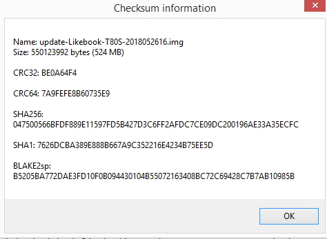

For me reflashing worked. Did you use "Restore" button? I think it should had been the "Upgrade" one. To make sure you used an intact .img file, I attach checksum of the one I used. The function to calculate it should be added to windows file manager menu by installing 7z
I have tried restore and upgrade. None of them work.
The checksum is the same.
