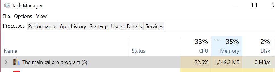

Meantime I connected a tablet as wireless device, had fairly quick update of metadata, but: since more than 3 hours, the tablet says "waiting for calibre" and calibre on my HP Probook (64bit) under Windows 10 is greyed out and showing no response.
At the same time, this is what my task manager reports (see attached image).
for your information, I have unistalled Calibre, turned off my Bitdefender, Rebooted and reinstalled and this is now still happening.
