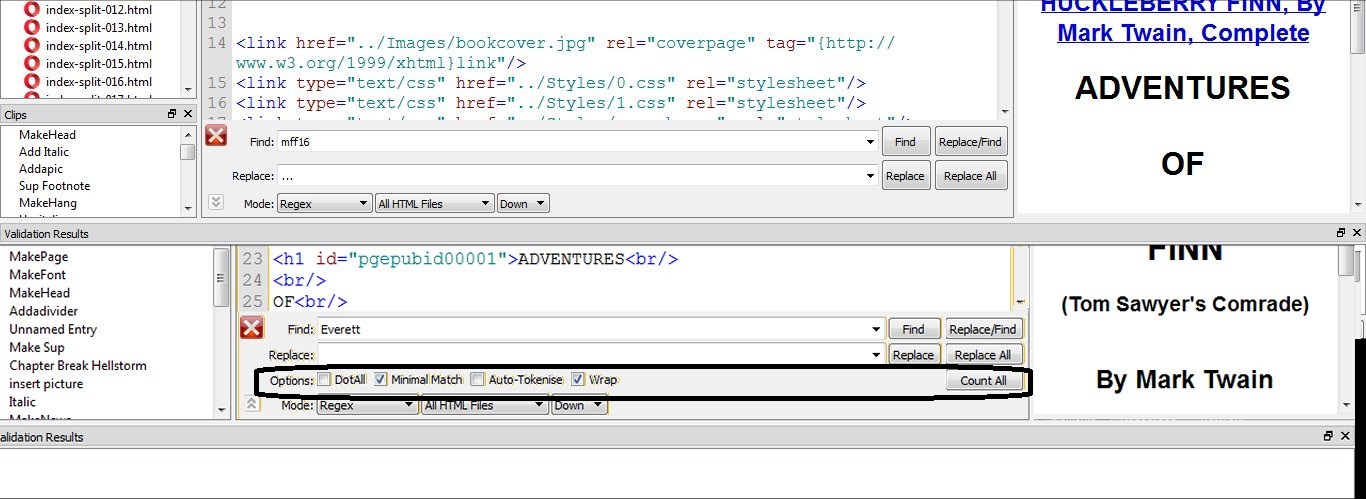

Good morning, DiapDealer and Kevin, just wanted to drop by and mention that the little discrepancy discussed in this thread, talking about how Sigil loses focus on the active page whenever it is moved, "popping" to the top in the Book Browser after the file is moved to a new location, is still occurring. You didn't commit to stopping this behavior, just said if it was possible you would.
But what I really wanted to talk about was something I'm really missing in the new release, that being the options below the replace line, including the "count all" button. If that was removed for reason, then I'll shut up, except to say that I (used to) use these functions a lot!
As always, for all your good work. This program is an essential in my day!

Old 08-26-2018, 12:42 PM   #103
Posts: 31,299
Karma: 62000000
I use the count all button, all the time as a sanity check (is the number in the range expected:either direction ) before I use the Replace all button

Originally Posted by JustinThought View Post
Good morning,
//snip!//
...including the "count all" button.
I probably should have said ESPECIALLY the "count all" button.
JustinThought is offline   Reply With Quote

Nothing has changed RE the Find & Replace UI in 0.9.10. I suspect you've accidentally hidden F&R's advanced options. In the bottom left-hand corner of the F&R widget, you'll see a button with two chevrons on it. Yours are likely pointing down (indicating that there's more to be shown). Just click it once with the mouse. The extra options (including the Count All button) will be visible (and the chevrons on the "Show/Hide Advanced Options" button will be pointing up).
