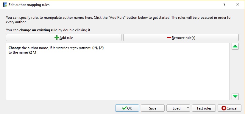

You can create rules to transform author names.
Preferences->Adding books->Adding actions.
I am not near my PC now but if you are familiar with regex you can do it. I will post the rule when I am near my Pc. Note that this is recent feature, you will need updated Calibre.

If all your author names are of a fixed format, you can create a rule as sammayor pointed out, otherwise you have to do it by hand.

This can be also configured for Metadata download.
I had not remembered that

I found it while adding new tag rule.
