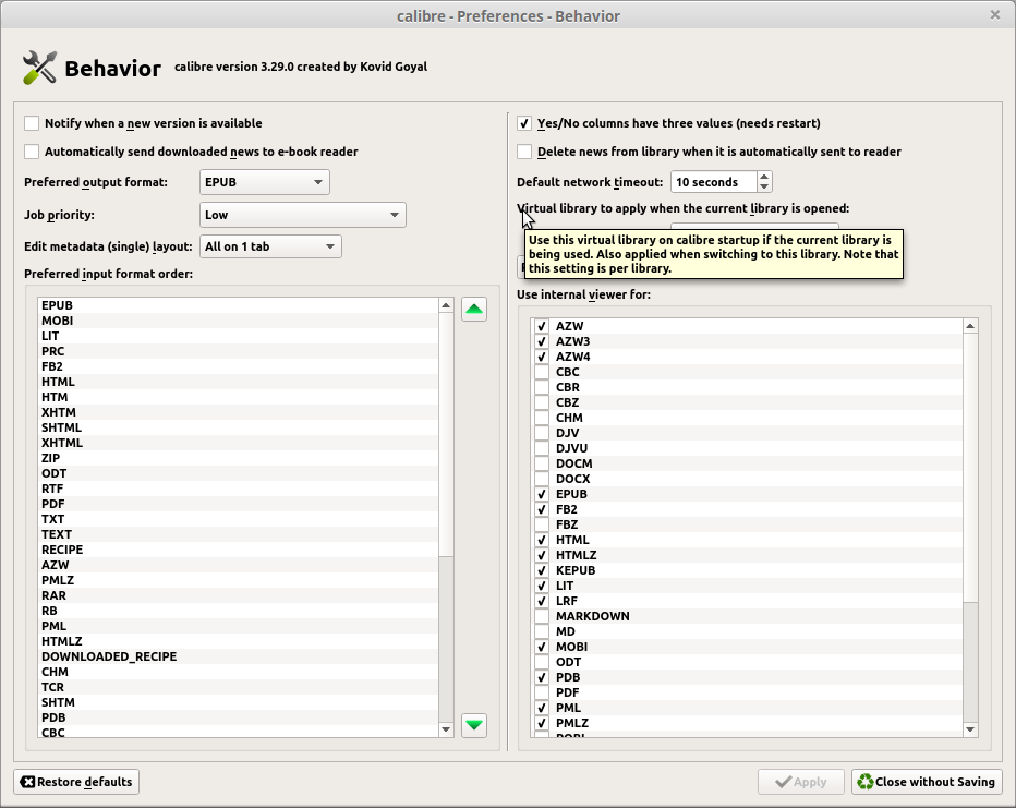

calibre preferences:
Name:	Screenshot from 2018-08-14 10-51-11.png

Thank you, Bernie! It works and helps a lot already!
However, it looks like the global option - so it opens same specified library at home and at work. I am still looking therefore for the option to dynamically select virtual library during startup.
