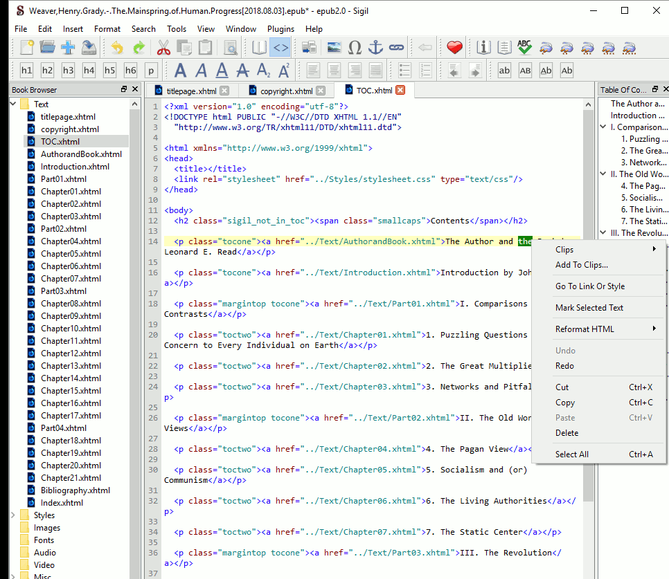

If you Right-Click, you'll get the context menu instead. It wouldn't place the actual cursor:
... and I took a few screenshots to help explain Step 2. This is after you click on a word in Spellcheck and it highlights in Code View:
