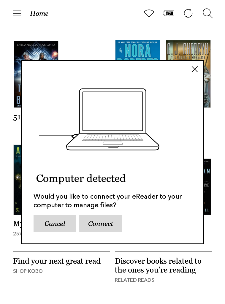

Alright, so the button width on the Glo is about 143px. That is approx 18.9% of the viewable width (758px). That's on FW 4.7.10413
sherman is offline   Reply With Quote

Oh, yeah, if you can post the screenshot, I can probably cobble something up .
EDIT: Another approach might also be to just scan the next N rows at the first hint of the two buttons, and then stopping if everything's okay, instead of finishing the complete loop and making a wild guesstimate at the end ^^.
Sure, Here it is.

Done .
Breaks early on match, tweaked the (horizontal) match thresholds to be much more lenient (hopefully that should cover everyone), and tweaked a tiny bit the coordinates fudging for the button's center.
'early' is currently set at after .5% lines, which is between 6 and 8 lines, so we still have roughly that again of headroom if it's not strict enough .
It's probably not terribly pretty (4AM brain), but it appears to work ^^.
