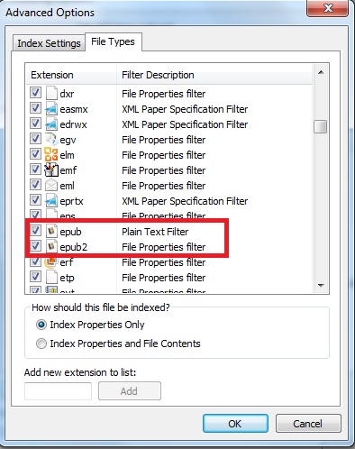

My textual ebooks either have DOCX, PDF or both formats. DOCX and PDF get completely indexed by WS and X1, which is why I keep the DOCX/PDF formats.
Interesting.
I added search file extensions for epub files which work reasonable well as epub are just text files (within a zip container). See attachment.
