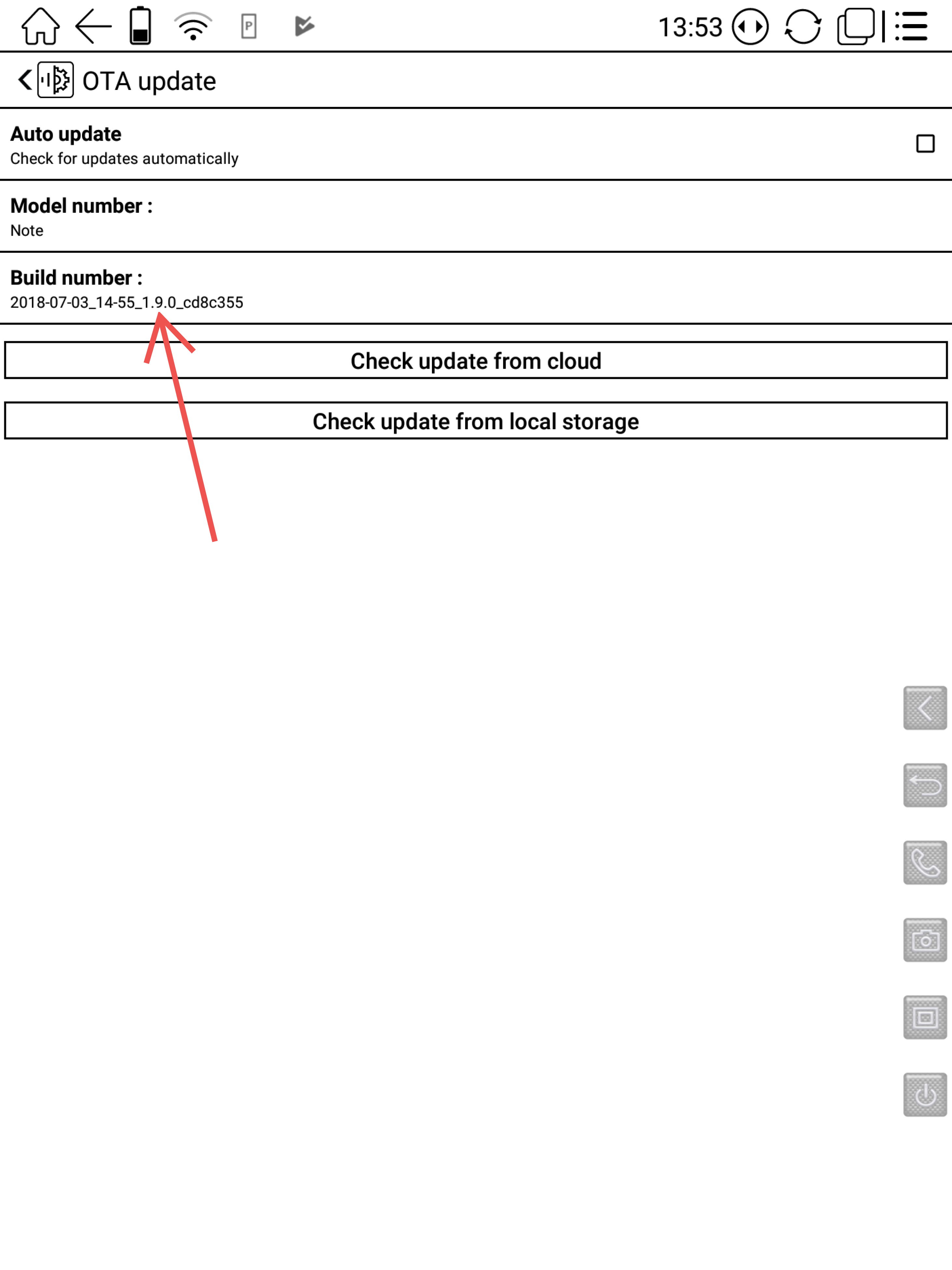

Originally Posted by Jon2555 View Post
Cicabum, it is v1.8.3. of firmware which was the latest version at the time.
Are your sure? About 2 weeks ago I've installed the version 1.9 by OTA
cicabum is offline   Reply With Quote
Old 07-24-2018, 02:33 PM   #10
Jon2555
Jon2555 began at the beginning.
Posts: 5
Join Date: Jun 2018
Device: Onyx Boox Note
I think you misunderstood me-the firmware from the link Booxtor posted is v1.8.3. He also said somewhere else that he will update modified version of newest firmvare(1.9.0) on ereader.store server but as I know we're still wating for it.
