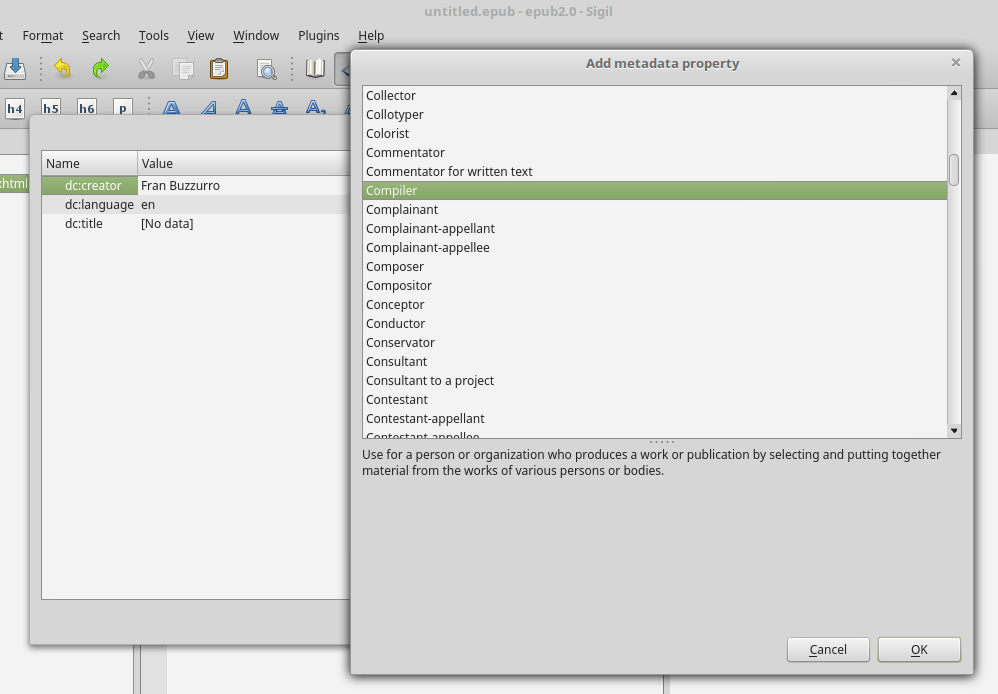

Anyway, I'm not sure to understand: how would you add the following metadata into the .opf file of an epub with the calibre metadata editor?
<!-- Attention to 'opf:role="com"' -->
<dc:creator opf:file-as="Dolci, Francesco" opf:role="com">Francesco Dolci</dc:creator>
<dc:rights>-SS- luglio 2018</dc:rights>
<dc:contributor opf:role="bkp">Created with EBC - the Electric Book Creator by Sasha Pavlowskij</dc:contributor>
<meta content="1.0" name="EBC - the Electric Book Creator"/>
ss
Sam Sahara is offline   Reply With Quote

The first is a comment, so I assume that isn't something you are interested in.
No, the first line was a message to you to pay attention to the attribute 'opf:role="com"' in the subsequent line; it is a DC element refinement of the "creator" element and stands for "compiler". The element refinements are correctly managed by sigil into his metadata editor, as you can see into the image: Click image for larger version
The dc:creator looks exactly the same as what calibre uses when it sets the author.
No, as I said the attribute is not 'opf:role="aut"' but 'opf:role="com"'.
Calibre doesn't seem to handle the dc:rights, but I also don't see it in any of my books. Is it a copyright statement or something else?
From the Dublin Core Metadata Elements set
Term Name: rights
URI: 	http://purl.org/dc/elements/1.1/rights
Label: 	Rights
Definition: 	Information about rights held in and over the resource.
Comment: 	Typically, rights information includes a statement about various property rights associated with the resource, including intellectual property rights.
The dc:contributor is what put there by the tool used to create the epub. Calibre will set this at appropriate times to itself.
The meta tag appears to be specifying the version of the tool that created the epub.
Sometimes one wants to edit that data by hand. The Sigil metadata editor gives this opportunity.
ss
