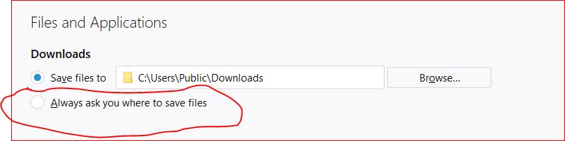

Uh! The Download button downloads to wherever your browser puts things.
I use Firefox and I set a 'Download' folder., But I could have set it to "ask" me every time and then I could selected the "connected devices folder" (see pic)
Other mainstream browsers have similar settings

Thank you theducks – that worked. I was thinking that some additional magic was being worked when loading a book to a device (conversion or renaming or something), but using the Download button on the server, and targeting the Kindle \Documents folder worked. Problem solved!
