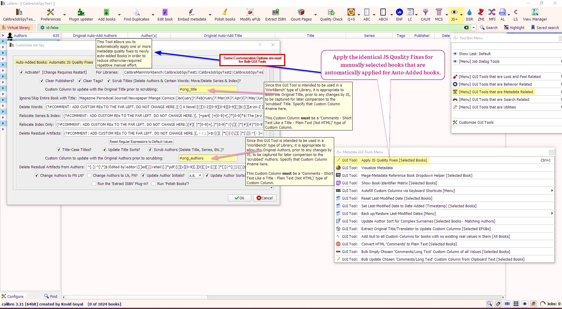

Now that you know and have tried the Standard Calibre way, try this plug-in:
https://www.mobileread.com/forums/sh...75077#poststop
See the attached image.
DaltonST
