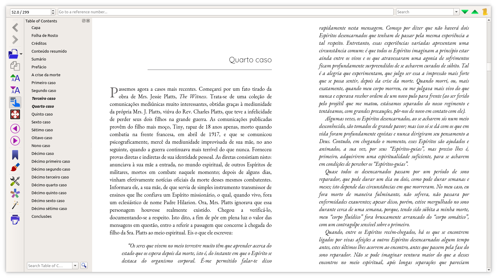

Your attached EPUB renders correctly on my linux system, see attached.
It might be that Qt's windows font backed does not like those fonts (I'm guessing you are on windows). Probably best to use a different font. It will get fixed in calibre eventually when I move the viewer from Qt WebKit to WebEngine, but that's still some time away.
