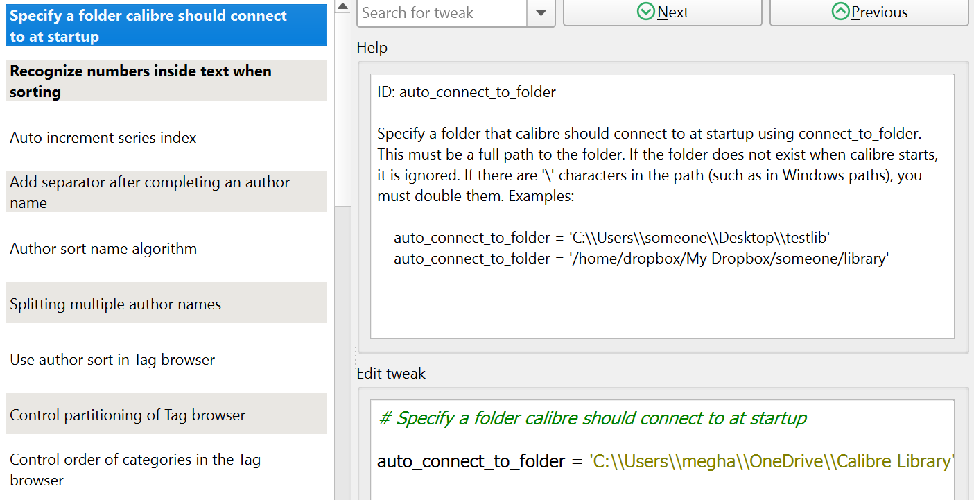

Thanks, Kovid! I checked that variable. It looks like it's already pointing to the right location (see attachment). Are there any other places or variables to check? Or maybe a file I can check to see if it's pointing to D: somewhere?
I guess one other possibility I just thought of. My library is at '<me>\OneDrive\Calibre Library'. Could it be that the laptop is restarting too soon after Calibre closes and before the main metadata.db has a chance to sync? Since there are no current updates requiring computer restarts, I'll leave it on with Calibre closed down and wait to see if OneDrive completes a sync of the folder. Just in case.
RESULT: Dang it. I closed Calibre, then made sure OneDrive had completely sync'd my files, then rebooted. Calibre launches pointing at D: still. Dang it. So that didn't do it. :'(

That is the only variable that controls automatic connect to folder at startup. If your D: drive is being connected to despite that, then it is likely your drive is being detected as a device. Run calibre in debug mode and you should see what device it is being detected as in the debug log, then you can disable the device driver for that deive in Preferences->Plugins

Go to the tweak again and remove the path. You currently have calibre set to automatically connect to C:\\Users\\megha\\OneDrive\\Calibre Library as a device. This tweak needs to be empty or it will always connect to this folder as a device on startup.
# Specify a folder calibre should connect to at startup
auto_connect_to_folder = 'Clear the path found here, click apply, then restart'

Thanks for response, Doc. To clarify, Kovid suggested checking that variable. I interpreted that he meant setting it to the folder the Library was at, but you're saying not to because it is being read as a device? Is this because the Library is on OneDrive or is it because auto_connect translates to any folder path reading as a device, even C: drive?
TEST: Last night I moved my library from OneDrive to C: drive. To understand your suggestion, I changed the auto_connect_to_folder variable to the new path, 'C:\\Users\\megha\\Calibre_Library_laptop'; applied change; quit/restarted calibre. No change; it restarted with a device attached.
Then I set the auto_connect_to_folder path to ''; applied change; quit/restart. SUCCESS!! No device attached. Thank you SO much for giving me a solution!

It is a Device setting, not the Start with Library setting.
Folder devices are commonly used when the manufacturers device can't be identified (specific device detection fails) or when a user wants to use "sneaker net" (SD cards) to get books to devices
