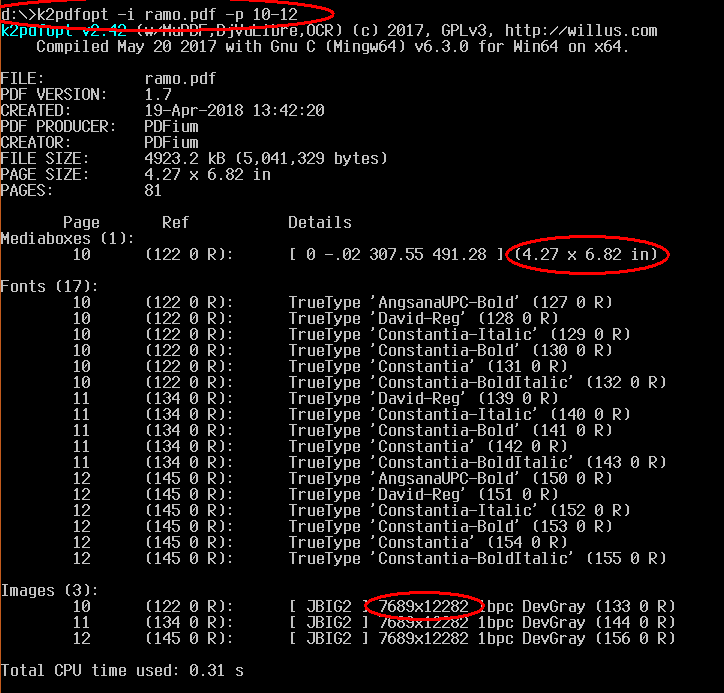

Originally Posted by Ramo View Post
Thank you! It is not the perfect one-button-solution for all my problems, but now I understand what is happening!
I learned about JPEG 2000 just 2 minutes ago when downloading a set of scanned images from archive.org and failing to make scantailor work on them. Talk about Sincronicity!
Way better suport that I've ever had from any company! You're awesome!
Just out of curiosity, do you have a guess of if KOreader would do a better job with this kind of pdf instead of the Nikel standart software on my Kobo TouchC? And how did you found out about the resolution of the images on the PDF, is there a option to do that on K2PDFopt? I Couldn't find it. And the JPX & JBIG2 on brackets on -i are the file formats of the imagens than?
I doubt KOreader will do much better than the standard reader. JPX/JBIG2 simply take a lot of CPU to render regardless of the software, but I cannot say for sure since I have not used KOreader myself. Posting that question on the KOreader thread will get more experienced answers. The resolution was obtained using the k2pdfopt -i option. See the attached screen shot.
