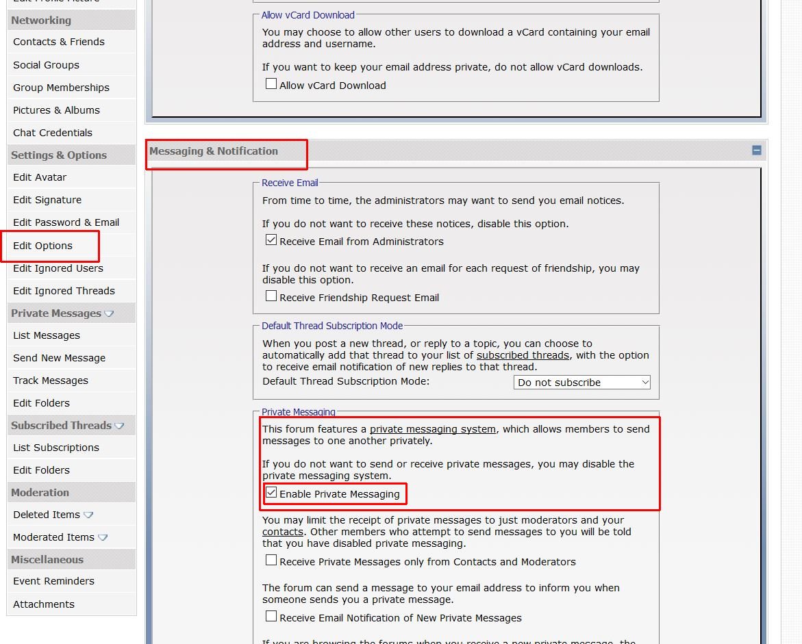

Old 06-14-2018, 08:56 PM   #2786
davidfor
Posts: 24,905
Karma: 47303828
Location: Sydney, Australia
Originally Posted by catlover1019 View Post
@ JimmXinu
Not there
You probably need to enable PMs for yourself. This is in the Control Panel under "Edit Options".
Old 06-14-2018, 10:19 PM   #2787
catlover1019
catlover1019 is an accomplished Snipe hunter.catlover1019 is an accomplished Snipe hunter.catlover1019 is an accomplished Snipe hunter.catlover1019 is an accomplished Snipe hunter.catlover1019 is an accomplished Snipe hunter.catlover1019 is an accomplished Snipe hunter.catlover1019 is an accomplished Snipe hunter.catlover1019 is an accomplished Snipe hunter.catlover1019 is an accomplished Snipe hunter.catlover1019 is an accomplished Snipe hunter.catlover1019 is an accomplished Snipe hunter.
Posts: 28
Karma: 123430
Join Date: Jun 2018
It's probably a major PEBCAK on my part, but I can't find any such option. If it is the same thing as "visitor messaging" I already have that enabled. I don't get any other options.
catlover1019 is offline   Reply With Quote
Old 06-14-2018, 10:37 PM   #2788
davidfor
Posts: 24,905
Karma: 47303828
No, it isn't the same as Visitor Messaging. There should be a separate section for "Private Messaging" above that. Others have said they don't have it and then later it appears. I thought it might be a number of posts needed, but 10 should be enough. Maybe it is a number of days membership. As an experiment, I did give you some Karma in case that affects it.
Old 06-14-2018, 11:05 PM   #2789
catlover1019
Posts: 28
Karma: 123430
Join Date: Jun 2018
@davidfor
No luck. That didn't seem to help.
Old 06-15-2018, 01:21 AM   #2790
Posts: 22,961
Karma: 34252880
You're looking for this:-
