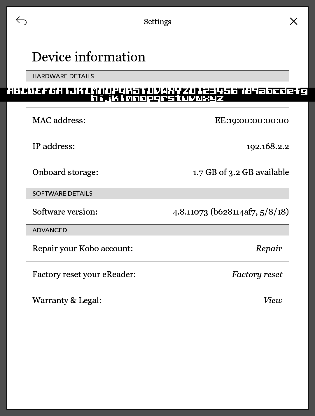

The lack of a small utility to print messages and images on screen (àla eips on Kindles) has been bugging me (and others, hi @frostschutz! ) for *quite* a while... So, I finally caved, and spent a few days working on this...
So here comes FBInk.
Basically, you feed it a string & a position on screen (row/column), and it'll print it there. Voilà.
There's a few helper flags if you want automagic padding, centering, or both, and it should break long strings over multiple-lines automatically (albeit in the dumbest fashion possible, no hyphenation, that's way out of scope here).
It has zero dependency besides the libc, since it's basically drawing monospaced monochrome glyphs straight to the framebuffer.
It's available as a standalone utility, which includes some of eips's more obscure features (like the ability to trigger specific mxcfb refresh calls without touching the fb at all), and as a C library, which is how I'm using it in KFMon.
Bindings are also available in Go, LuaJIT & Python .
Since v1.2.0, it can also display images, in the most common range of formats, with or without transparency .
Since v1.8.0, thanks to @sherman, it can also render OpenType/TrueType fonts .
ID:	164459   Click image for larger version
ID:	164460   Click image for larger version

@cramoisi: Generally, yes, with some caveats if the software rotation doesn't match the hardware rotation. (i.e., it'll be printing at a 90° angle in KOReader's landscape mode) .
I'd be glad to know how well that actually works, though ^^. And since you still have a 16bpp FW, if the colors are indeed inverted by default .

This one should fix the broken colors on Kobos running @ 16bpp, as well as placement & orientation when out of Nickel (we no longer print at a 90° angle in these cases ;P).
The main drive was fixing the specific use-case we have for this in KOReader, but this may have fixed it also in general under KSM (as long as there's not another layer of software orientation on top, i.e.: in Upright Portrait mode only).
