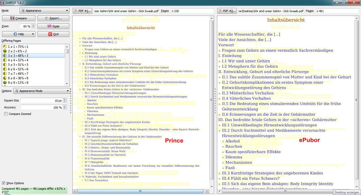

I don't think that limitation regarding filenames (length or allowed characters) in Windows are the problem, the name was created from Calibre and all Windows operation with this file (including automatic synchronization of the lbrary) are working well.
I understand that the plugin defaults to small pages (for reading in an ebook reader) but why epubor converting the pagesize correct from epub to pdf? For me that's the same situation.
The reason why I hope that the problem can be fixed is that I build some month ago something I called e-Book Postprocess Toolbox and I want to build in the near future a new updated version. There was Calibre integrated and it would be fine if the next version has a integrated Prince plugin.

Have you tried without the "PDF zum Bucheintrag hinzufügen" option? (I don't use this option, so it is less tested, even in Linux.)
What do you mean? It seems to me your epubor results have an A4-like size (margins/font size relative to page). You can get something similar with Prince and this plugin if you change the defaults under @page.
If the book has, for example, some hard-coded font or picture sizes such that some element takes 15 cm, it will fit a 21 cm wide page with 2 cm margins, but it won't fit a 9 cm wide page with 2 mm margins. If the book is coded in such a way that this element cannot scale or reflow... well, it's the book's fault. The other difference I saw in your example is that one version has an "Overview" where the other has the TOC, this could be due to epubor ignoring nonlinear elements, or adding something of its own, or some other tricks. If you can share an ePub file and specify what you would like to get, I may be able to devise a style file for conversion.

You are right the book that I used for the first test includes much errors. After your comment I open it first in Calibre editor and there where no important errors shown after test (only 2 parts to big) but after using pagina EPUB-Checker I was shocked. The error list was so long that I stopped the tool and the check in Sigil with the FlightCrew plugin results a similar error list.
Next test was with a purchased epub where I only removed the DRM and here was only one unimportant error in pagina EPUB-Checker. The first result was for the trash and I started to change some page definitions and after playing around a wile I was happy with the result. (see attached pictures)
I think your argument why you delinted the page size can't be accepted. No normal user will read a eBook in PDF format on a eBook reader if he has the epub. Normal use of a PDF is on a tablet, handheld or computer and in my opinion the eBook should look more like a normal book. That was the reason to not only change the page size to A5 (14,8 / 21 cm). I also changed the margin to 15mm.
For the moment there is for me only two question left
  1. Can I and if yes how define some different output size / style definitions like A4, A5 (German norm size for paper) for example that could be loaded?
  2. Is there a known tool that can fix errors without handwork in a epub?
Name:	book with errors in Calibre epub editor.jpg
ID:	164373   Click image for larger version
Name:	compare Prince A5 with ePubor 1.jpg
ID:	164374   Click image for larger version
Name:	looks more like a book.jpg
Different usages for different people. I created the plugin for myself first, and for anyone else who might find it useful. I don't typically create a PDF, but if I do, it would be for reading on screen, computer or ebook reader. Even in a computer, I'd prefer the font/page size ratio of an ebook reader rather than A4. A5 would probably be fine too. Note that what you find when you first install the plugin is just some default I thought could be sensible or useful as a starting point, feel free to modify it to your liking.
There could be several reasons for reading a PDF instead of an ePub in an ebook reader:
  1. Maybe the reader does not support ePub at all (like some older ones).
  2. Maybe the reader does not support some features the ePub uses or the user would like to have (like some specific font, some CSS properties...)
  3. The typesetting quality (linebreaks, ligatures, kerning, etc.) is probably better in the PDF than in the direct ePub rendering, i.e., Prince cares about typesetting more than Adobe.
  4. Page breaks are fixed in the PDF, and page numbers match the actual pages. This can be desired for annotations and sharing between different readers (people or devices).
Yes, there is. Click Configure, then in Custom Styles you can create, rename, add, delete styles, which you can then select in the "Benutzerdefinierter Stil" drop down list.
I don't think so. There's not even an agreement on what's an "error".
