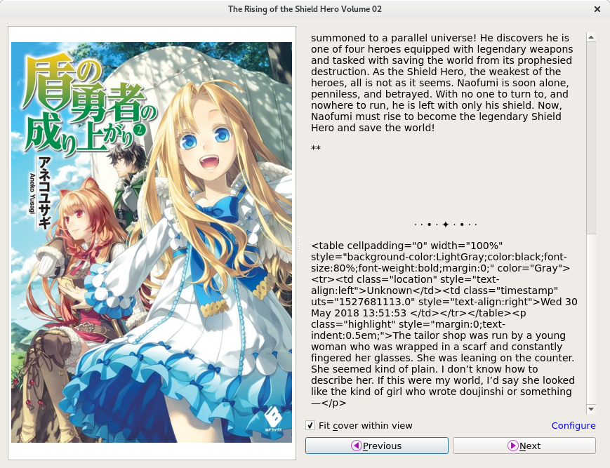

Just tried the plugin (got it from the calibre plugin browser thingy)
Fetching works just fine, the problem is the comment field is full of 'unused' html tags.
Is there any way to simply remove / not use those at all? The modify appearance option doesn't seem to have something like that.
I get the same problem with a kobo Glo HD. It used to work fine but after updating the kobo I get the same problem, some of the HTML is displayed instead of being interpreted. (Kobo Firmware 4.8.11073)
Example of an annotation:
<div class="user_annotations" style="margin:0">
<div class="annotation" genre="" hash="14930018755f664a247d5283c50a1acf" location_sort="001003" reader="KoboTouchExtended" style="margin:0 0 0.5em 0">
&lt;table cellpadding="0" width="100%" style="background-color:LightGray;color:black;font-size:80%;font-weight:bold;margin:0;" color="Gray"&gt;
&lt;tr&gt;
&lt;td class="location" style="text-align:left"&gt;Chapter One&lt;/td&gt;
&lt;td class="timestamp" uts="1527709969.0" style="text-align:right"&gt;30/05/2018 21:52:49&lt;/td&gt;
&lt;/tr&gt;
&lt;/table&gt;
&lt;p class="highlight" style="margin:0;text-indent:0.5em;"&gt;Twilight had fallen&lt;/p&gt;
</div>
</div>
It uses &lt; and &gt; instead of < and >
Since I don't sync the annotations everytime I'm not sure it's due to the kobo update, but I don't think I changed anything else.
&lt;tr&gt;
&lt;/tr&gt;
&lt;/table&gt;
</div>
</div>
None of the tags that use &lt; and &gt; come from the device. They are part of the code that the plugin generates when formatting the annotation. Nothing has changed in the plugin, so it must be something in what calibre is doing when the annotation is put into the column. It is interesting that it is affecting the table and paragraph tags and not the divs. Are you using a separate column, or the comments column like @ageha is?
In any case, I will have a look at it over the next few days. Also, what version of calibre are you using? The more recently it started, the fewer changes I have to look at.

Beta: Fix coding of annotations
The problems reported above appear to have been caused by an update to BeautifulSoup in calibre. And to be honest, it shouldn't really have worked with the way it was written. I have fixed this and the attached beta appears to be working correctly. Please try it and tell me how it goes.
Yep that works for me, everything looking fine right now.

Update to version 1.8.0 - Two bug fixes
I have just release version 1.8.0 of this plugin. This is to fix the recent problems with calibre 3.24 and later. The changes in this version are:
  • Fix: Version of BeautifulSoup was updated in calibre 3.24.0 and the plugins usage needed to change.
  • Fix: Error when moving/updating annotations.
Calibre will announce the update in the next hour or so. And as usual, if anyone sees any problems, please report them here.
