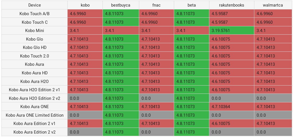

The reason why it does not appear to be available for the KA1LE is because they now seem to do more checks on the upgrade check.
https://api.kobobooks.com/1.0/Upgrad...81/beta/0.0/N0 -> 4.7.10364
https://api.kobobooks.com/1.0/Upgrad...a/4.7.10364/N0 -> 4.7.11073
I'll fix this later today by adding multiple layers to the checks based on the previous version.
I've fixed the upgrade check. The OP may want to update the first post by regenerating the bbcode to also include the KA1LE.

Here is the current affiliate availability for major affiliates for this version so far. Recently, bestbuyca seems to be the first one getting new versions.

Kobo doesn't release the updates to all affiliates immediately, so it's definitely possible that for the ones you used, the latest firmware available was still 4.7.10413. The device would check that the firmware installed didn't match (with the first 4.8 firmware being pulled and all) and that would trigger the "update".
The only person who updated via OTA in this thread so far used the "beta" affiliate, so that's a possibility for those that didn't sideload.
Mine updated OTA via bestbuyca the same day this thread was started.

In my case, the affiliate was bestbuyca. The firmware was at 4.8.x from last April. After the OTA update, the firmware was back at 4.7.x Still on the bestbuyca affiliate. So far, the only thing I can think of, is that there was a problem only with Kobo Aura One and the way the firmware was packaged. See my earlier post.
