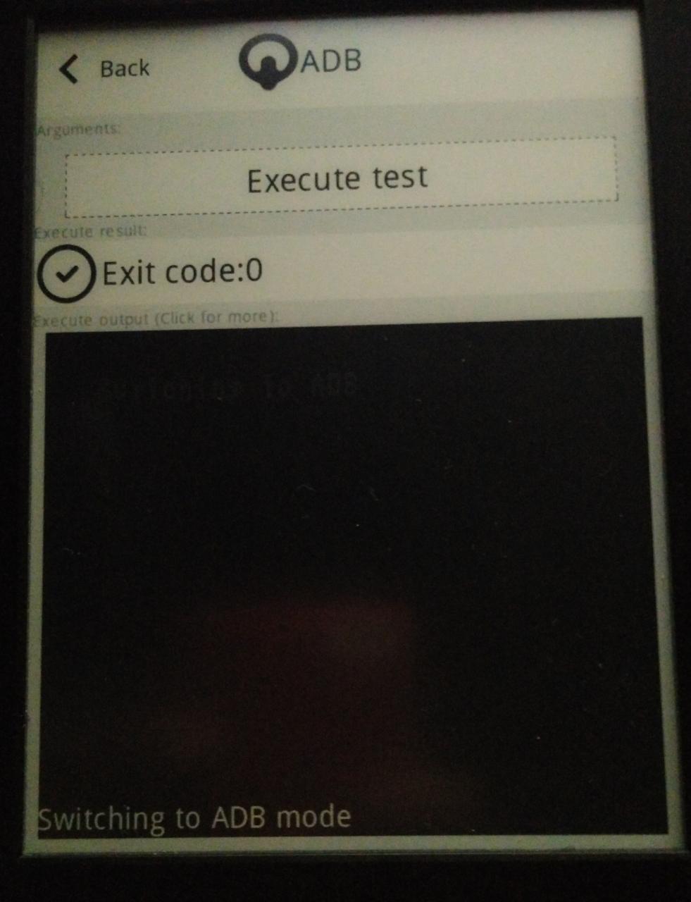

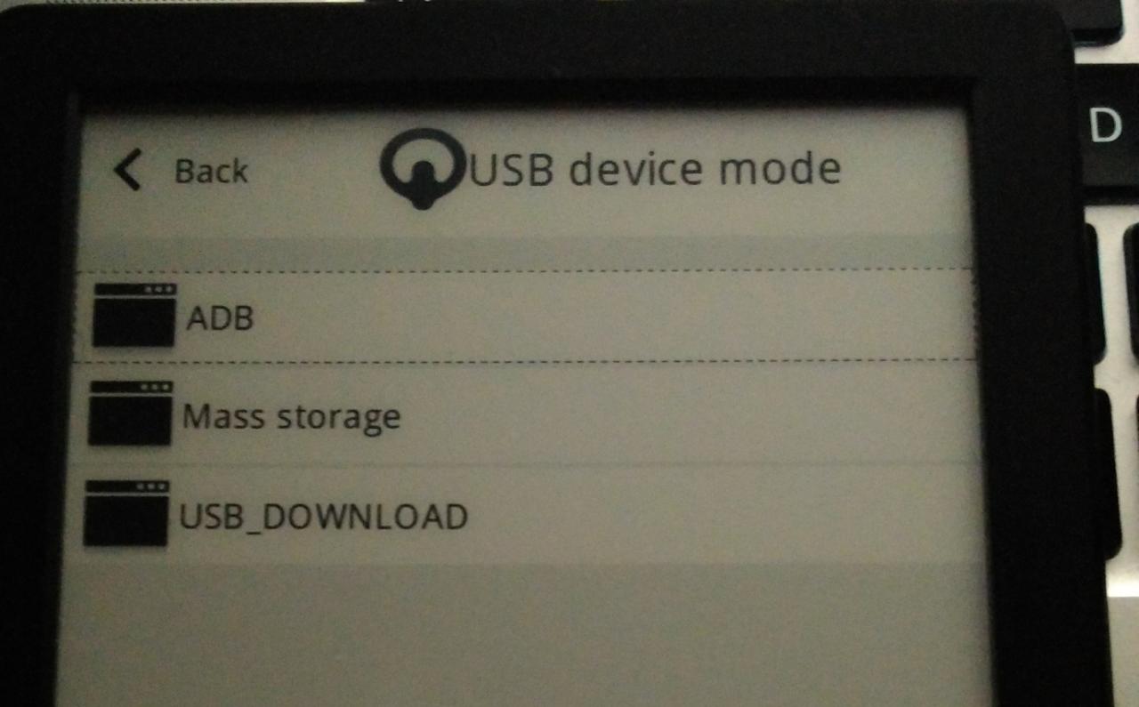

Talking verified again
So after reading your comment, I tried again enabling adb in diags and yes I wasnt dreaming..
Attached are snaps i took while in diags mode.. 1st one is choosing usb in adb mode.
see if the device is recognised in adb
$ adb devices -l
List of devices attached
P0011807638506JH       device usb:336592896X product:zeux_fox model:fox device:fox
$ adb version
Android Debug Bridge version 1.0.39
Revision 3db08f2c6889-android
Installed as /usr/local/bin/adb
After that just launch adb shell to get in kindle

@kapaggar: Huh. Guess they sprung a new diags rootfs/menu on us. (And that it supports adb is new, hence @knc1's surprise, we're used to USBNet & dropbear ).
For the record, you don't have any issues exiting from diags and restarting into the main system?
And is there actually a menu mentioning USBNet and/or SSH?
Once you've made proper dumps of all this, I'd sure be glad to take a look at it... .
I hope you are doing great in life..
I am only a week old in kindle areana.. only reading with android KOReader till now. so thanks for having patience with me. I have linux exposure but heard lab126 two days ago and how things are structured in kindle world. Going through upstart scripts rn.

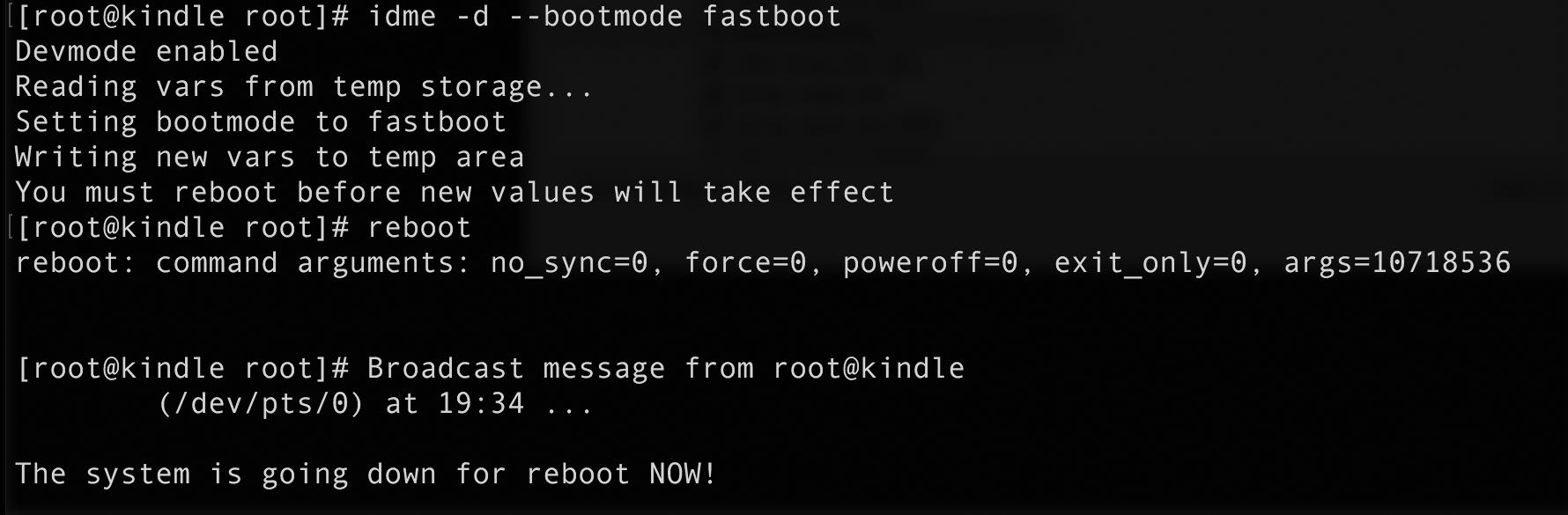

No.. just idme -d --bootmode main in adb shell and restart
No, under USB mode there are 3 options.
1. adb
2. mass storage ( havnt tried this )
3. USB_DOWNLOAD ( opens usbms and if update file stored in its root processes it after i unmounts usbms .... i tried this to downgrade from 5.9.5 to 5.8.10 but update error 15 came)

Do you do anything special to boot into diags to get to that ADB option, are you using the shell script in rescue pack, or using the serial port?
Thanks for any more information you can give!

> installed RP ( failed first attempt) and then got into diag via "idme -d --bootmode diags"
so now my diags partition is not pristine as it contains usbnet ssh dropbear etc
It s only now i found that I can make /ENABLE_DIAGS in main and reboot to get in diags mode.

I tried to check like adb if fastboot also works like android on KT3 .. Bricked
From main bootmode I launched idme -d --bootmode fastboot
and now its stuck in some strange mode..
not getting detected as USB / fastboot / adb in mac or windows10
Time to make a saperate thread asking for help and all things that come with it..
