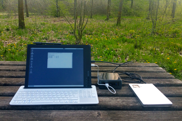

The set-up is composed of:
-- the Max2 using the modified HDMI Monitor app, and the touchscreen functions;
-- a MiniPC, that * for its very low price provides a speed compatible with not-so-old high-end desktops, * weighs like the tablet and is as big as a fist, * is almost completely noiseless, and * consumes an unbelievable 10 watts, measured;
-- a BlueTooth keyboard that also offers a mousepad, the luxury of a numpad and a slot to host your devices, slanted.
Add an external battery... 20,000 mAh in this case.

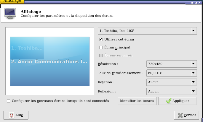

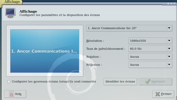

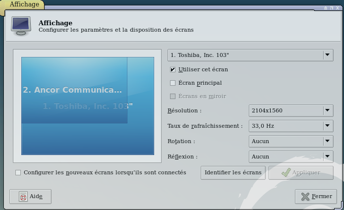

Linux Debian Stretch, Max2 with 720x480 doesn't work.
Hello,
I'm using a Linux Debian Stretch station. I use Xfce4.
The Max2 is seen as a 10.3" Thoshiba monitor : 2104x1560 pixels (33,0 Hz) or 720x480 pixels - 60 or 59.9 Hz.
There is no problem with the 2104x1560 resolution, but impossible to use the 720x480 resolution. My main monitor is a 20" ASSU vW202SR with only 1680x1050 pixels seen as Ancor Communications.
It doesn't matter if the two area used by the monitor are the same or not, or if the Max2 is the main monitor or not.
My video card is :
> lspci | grep VGA
00:02.0 VGA compatible controller: Intel Corporation Device 5912 (rev 04)
> lsw
*-display
description: VGA compatible controller
produit: Intel Corporation
fabriquant: Intel Corporation
identifiant matériel: 2
information bus: pci@0000:00:02.0
version: 04
bits: 64 bits
horloge: 33MHz
fonctionnalités: vga_controller bus_master cap_list rom
configuration: driver=i915 latency=0
My problem is the image on the MAX2 is so small, that I can't read on the screen. The only solution is to use a ENORMOUS size of font and put the window on the area used by the Max2.
Any idea ?
Thanks.
