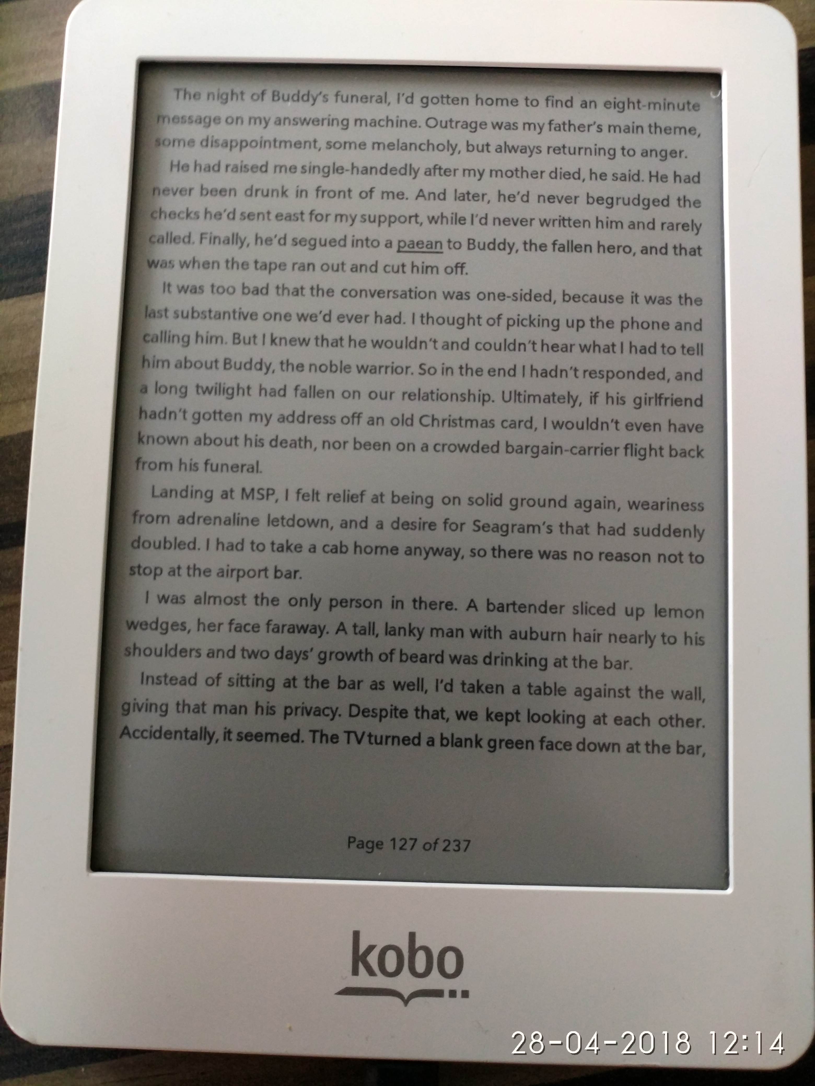

Picture of screen

Originally Posted by stonegrey View Post
Picture of screen
I don't see any damage to the screen.
As light button and led is working it does indicate that the screen is not responsive.
oren64 is offline   Reply With Quote

Surely the backlight would work if only the screen was faulty, especially as the backlight works when android is installed.
stonegrey is offline   Reply With Quote

@stonegrey: Broken screen was my first thought, but I can't see anything wrong with the screen.
About the only thing I can think of to try is a new SD card with the image. I don't think that is the problem, but it is something to try.
Do you think its a screen fault, or a motherboard issue? I don't particularly want to buy one, only to find that its the other.
I have cleaned the screen around the edge of the bezel, just in case there was something there, but that did nothing either.

Sorry, I don't know. I can't see a problem with the screen in the image. But, some screens show cracks on the back that aren't visible yet on the front.
are these touch screen, or infra red beam?
The Glo is infrared. It does mean you need to get it back together properly for the touch to work. But, I don't think this is getting to the point where the touch is activated.
