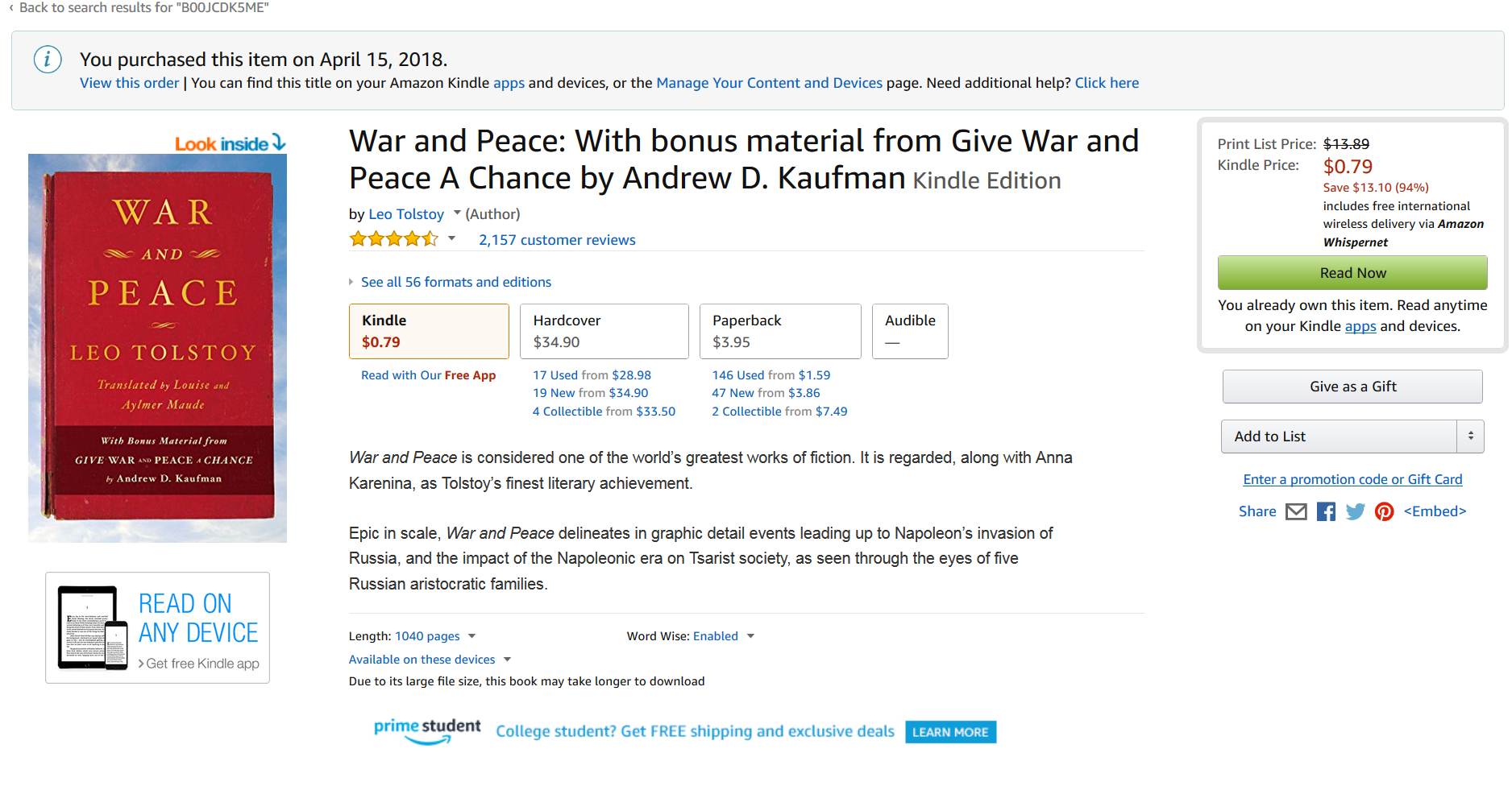

EDIT: my error I needed to scroll down to see that X-ray *is* still enabled.

Originally Posted by PoP View Post
Interestingly, it is not X-ray enabled anymore
Attachment 163547
I just bought it yesterday, and my copy that downloaded to my Oasis 2 has x-ray.
ETA: Your screenshot would not show whether it has x-ray or not. Scroll down to the real details, and I see:
Attachment 163547
You need to scroll down to view other details/features: X-Ray is Enabled.
