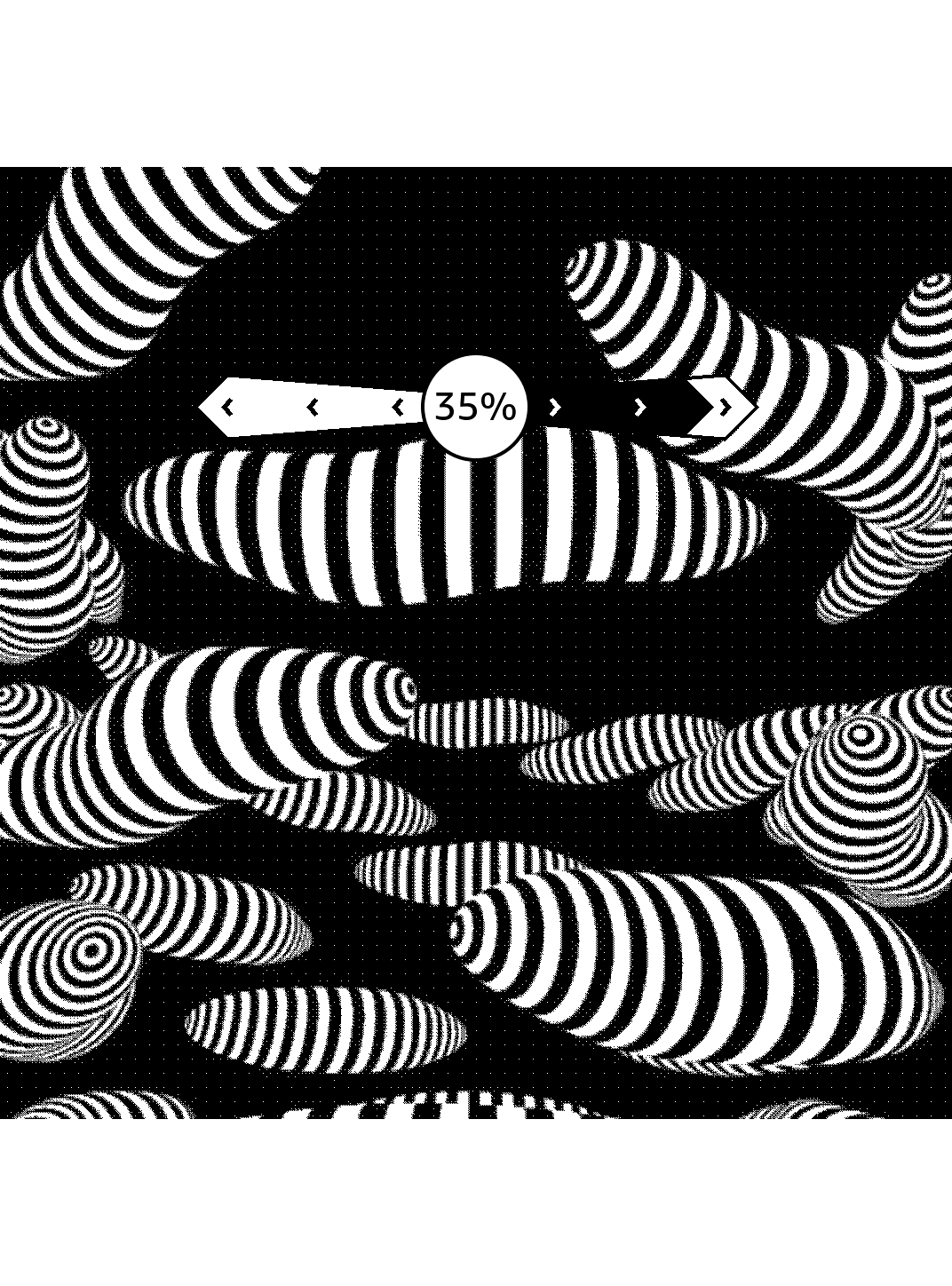

Simulating GIF animations
(Just to document)
I extracted the frames of an animated gif and used Kindle Comic Creator to produce a KF8 ebook.
Following the Converting Comics and Manga OP's instructions, I then used the plugin to convert from the KF8's opf to the KFX format.
My goal was to use the « fast continuous page turns » manga feature to reasonably simulate the gif animation.
Name:	Moving Worms screenshot_2018_04_14T10_23_42-0400.png
It pretty much worked!
See for yourself:
