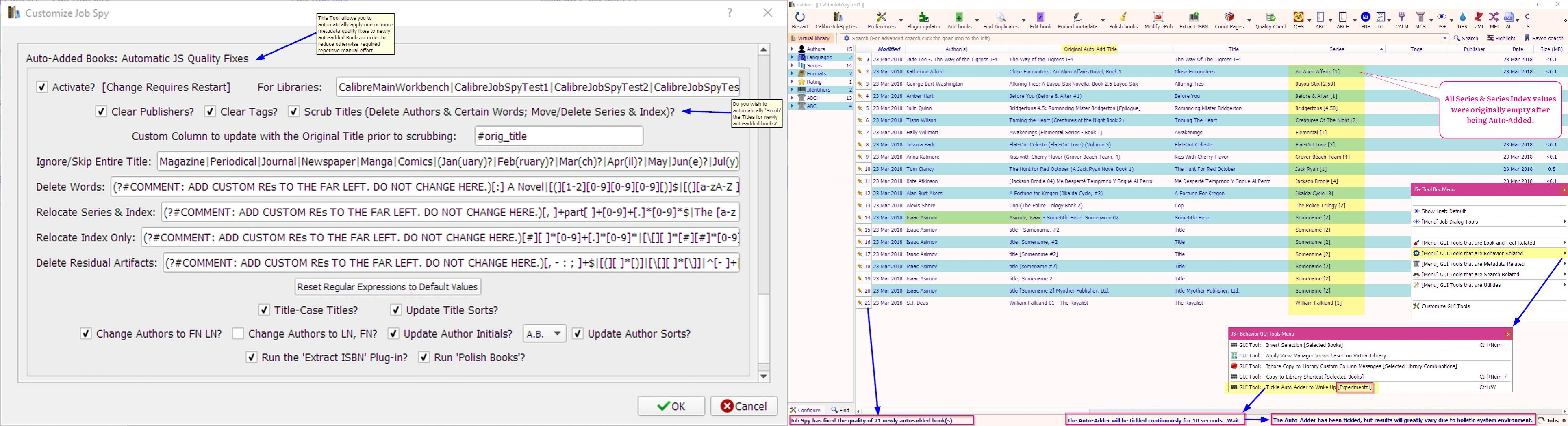

Originally Posted by jecilop View Post
@Sarmat89,
I tried something as a shortcut using this code and the \1 in the Replace field.
I used it also on a title that did NOT have any info in the parentheses.
Example 1) This is the title
2) This is the title ( This is the series 5)
This resulted in a the first listing using "This is the title" while the second listing used "This is the series" (the latter being the original intention.
I'm just curious if there is a way to make the code ONLY have a result IF there are ( ) present in the title such that listing one has no result.
I can isolate the listings with ( ) easily to do this, but I'm just wondering if that step can be eliminated.
jecilop:
Yes, if you use the Job Spy toolbag of (currently) 46 tools for doing things like that to make using Calibre more effective and/or efficient and/or simple, or just if you want to have colors. See the 2 attachments below. The Auto-Add Books "Scrub Titles" tool came first, followed by the "Scrub Authors" tool.
https://www.mobileread.com/forums/sh...42118#poststop
DaltonST
n.b. After reading everything else, this post might be useful to you: https://www.mobileread.com/forums/sh...7&postcount=17
