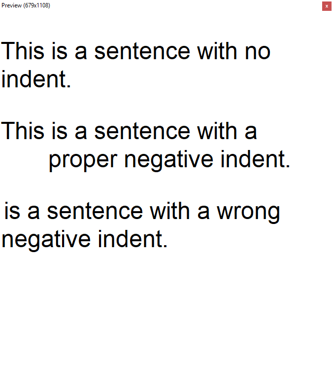

Looking at that, my first thought*, is that someone is playing games with the left margin and have ended up with a negative margin in the CSS. Or maybe a negative text-indent. It looks like a case where the renderer is doing exactly what it is told to do, but what it is being told to do doesn't work properly.
Yep. I'm thinking they used a negative indent, but forgot to set the left margin as an equal and opposite.
Example Code:
<body>
  <p class="noindent">This is a sentence with no indent.</p>
  <p class="correct">This is a sentence with a proper negative indent.</p>
  <p class="wrong">This is a sentence with a wrong negative indent.</p>
</body>
CSS:
.noindent {
	text-indent: 0;
.correct {
	text-indent: -2em;
	margin-left: 2em;
.wrong {
	text-indent: -2em;
	margin-left: 0;
Seems like it's just the case of a poorly formatted book.
Only way to correct it is to open it up yourself and fix the CSS, or to contact the author/publisher and let them know about the formatting error.
