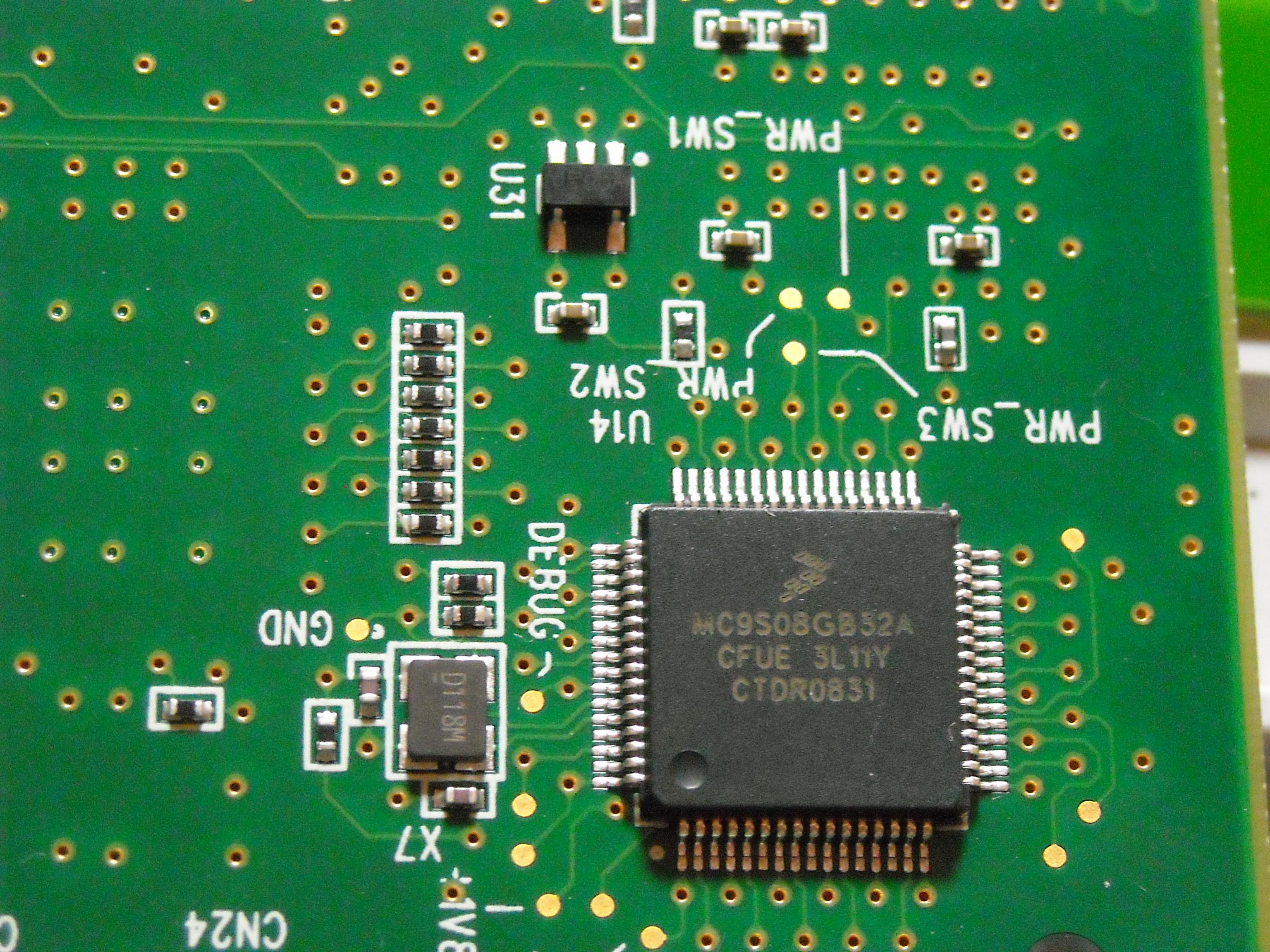

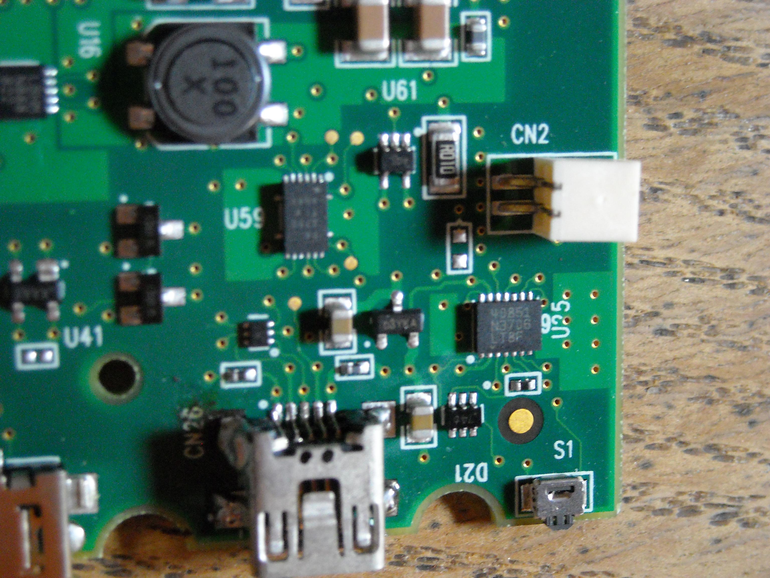

Originally Posted by elbastorius View Post
Kleykenb, just a few more observations:
- when looking harder on the U17 region I suspect now that it is an empty placeholder. Is that correct?
- there is a region (delta chip side, when delta chip is up and right, then the region is immediately above and including the usb connector, and streching to the right cn10 cap. sensor stripe connector) that is not covered by any hirez image. There are a couple of ic-s of interest.
- the picture showing U14 is out of focus. U14 should be the mcu chip, so could you post the type number of it.
Hi I've got the pictures for you. Have fun :-)
ID:	29376   Click image for larger version
ID:	29377   Click image for larger version

The 'empty spaces' on the board could be for the wireless functionality. It is common in consumer electronics to design a board for the 'full functional'-model and then leave off some components (and probably use different software) for the 'lower cost'-model.
The location where U17 should go seems to be 'shielded', which is normally only needed for high frequency ICs, which also points into wireless functionality.
