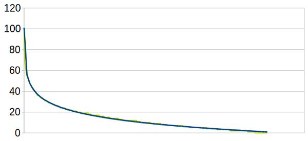

I took a little time to get some stats:
-- the double tap time can be very subjective (affected by age?), but mine kept lax varied from 100ms to 350ms, with an average and median of 250ms. I think that to keep the "timedelta" value at 800ms will be safe.
-- the tap displacement in pixels, I think I well guessed it with 50:
7% of the deltas were beyond 40px, which means a success rate in double-click action of 85%;
4% of the deltas were beyond 50px, which means a success rate in double-click action of 90%; a few were beyond 60px. I attach a chart.
EDIT: a bit more empirically:
30px → 80% ; 35px → 85% ; 40px → 89% ; 50px → 93% ; 60px → 95%
EDIT2: I removed the former image because it was shamefully wrong. The distribution revealed to be a logarithmic distribution (10000 cases will err within 20, 1000 within 40, 100 within 80, 10 within 100 ... ).

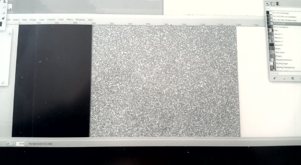

With the current progresses, using the Max2 as monitor is coming just short of amazing, productivity wise, realistically speaking.
The problem remains of that flashing.
It happens with colours that once pre-processed by the Max2 become akin to #808080 and very close neighbours: it happens with #7f8180, but not with #7f7f7f or #828282.
Now, the posted example should make it evident...
