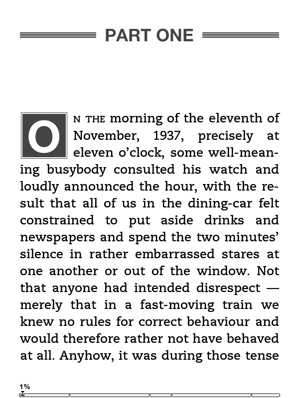

If you are going to work with .kf8 (not the old .mobi format) then don't use <hr> tags but "borders" since you can do whatever by styling borders. For example, watch the borders I employed in the following screenshots of a .kf8 ebook:
ID:	162582 Click image for larger version
You can do something like that by reducing the height of <hx>, <div> or <p> tag to 2 or 3px and then to style the upper and bottom border as you wish. Of course, all that only works with .kf8 (not old .mobi).
