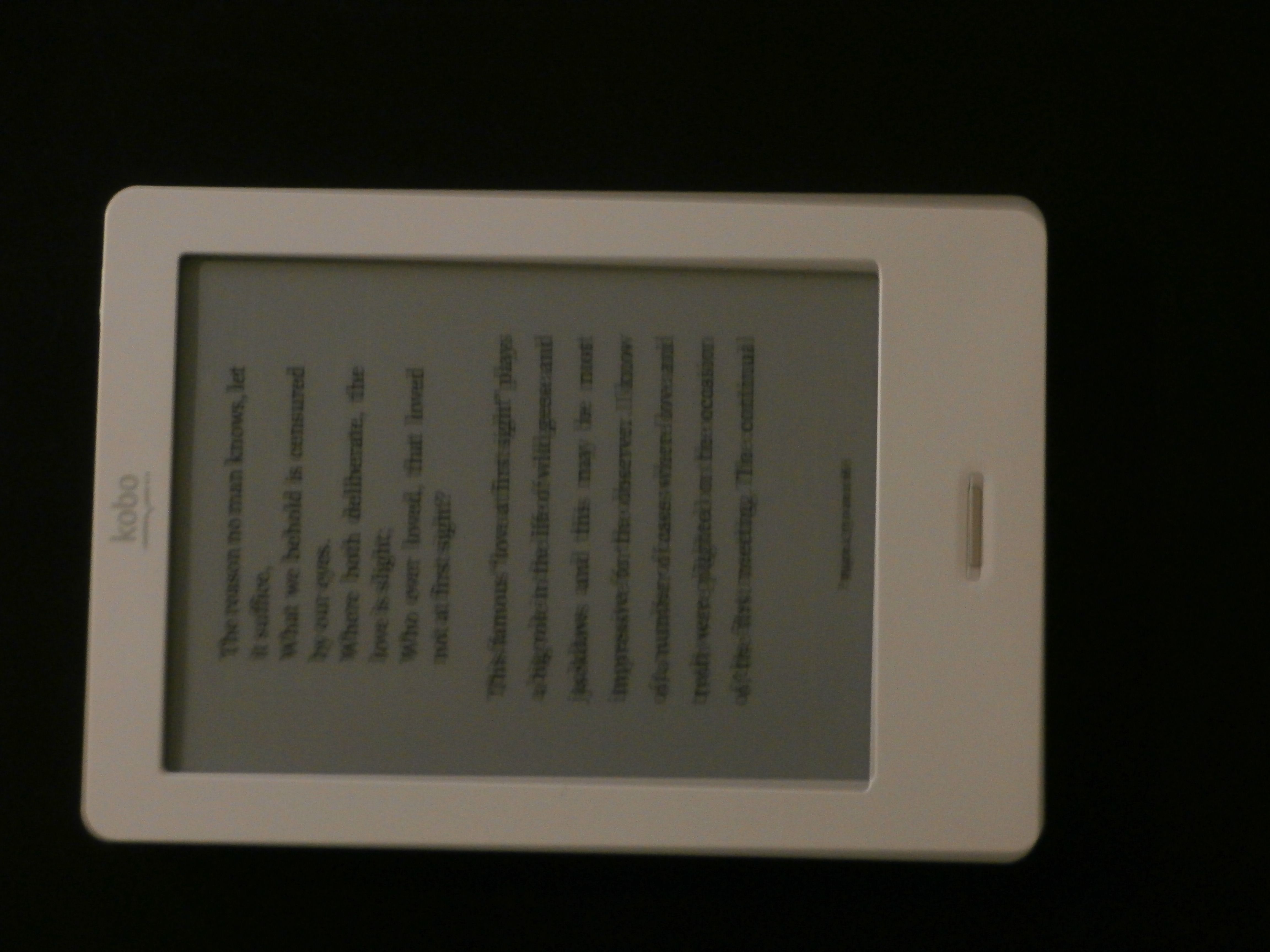

I was gifted a Kobo Touch that worked fine for about 5 days and then got stuck on one page. It's been there ever since.
What I've tried in vain so far:
Holding the slide button to the right on top which should start up the device.
Holding the slide button to the right while simultaneously keeping the home button on front of the device pressed down which should factory reset the device.
Reset the device with reset button/hole at the back of the device.
Connect the device to my computer with a USB cable.
None of these actions have worked.
The screen does not appear to be damaged though ( see photo), so now I'm waiting until the device's battery is fully discharged hopefully the device will reboot then.
Ideas are most welcome.
Thanks in advance.

Your Kobo may actually already be fully discharged--it is just displaying the last screen it showed before being depleted of power.
I suggest plugging it in to a wall outlet and charging it overnight.

When I hold the slide button to the right the blue light on the reader still turns on so the battery is not fully discharged. It was on 74% prior to the reader getting stuck.
I think that waiting until the battery is fully discharged is still my best bet.

Connect the device to PC and touch where the "Connect" button supposed to be, if the computer detect the device, the screen is not responsive.
Not quite the full manual reset procedure.
  1. Slide and hold the power switch to the right for 30 seconds to force a power off.
  2. Release the power switch.
  3. Press and hold the home button then slide the power switch to the right.
  4. When the LED lights up, release the power switch while continuing to hold the home button. You may have to slide the power switch a couple of times.
  5. Continue to hold the home button until the LED starts to rapidly flash.
  6. Release the home button.
Your Touch should now go into it's restoring routine. An alternative is to hold the home button while using the pinhole reset.
Thanks for your suggestions. I've tried both procedures, the device is still stuck on the same page, unfortunately.

I suspect a broken screen. Haven't had any bumps or drops?
Broken e-ink screens manifest in different ways: my son's Touch screen still changes (black/grey/white) but doesn't display anything anymore; I have a dead Glo which displays half of a book cover and then some stuff that looks like blotches and diagonal lines, and my first broken Aura (yeah I've been around) manifested like what you describe (text remained on screen, but nothing I did made it change).

You may be right, the device did fall off the bed to the floor (not even a heavy fall) prior to getting stuck.
If they're that fragile then this will have been my first and last E-ink device.

They are extremely fragile, due to the glass substrate. There are flexible e-Ink screens but you don't find them in consumer devices. ( http://www.eink.com/flexible-technology.html ). It's probably fair to say it's the biggest weakness of this technology.

When you Touch fell on the floor, did it have a case on it?
