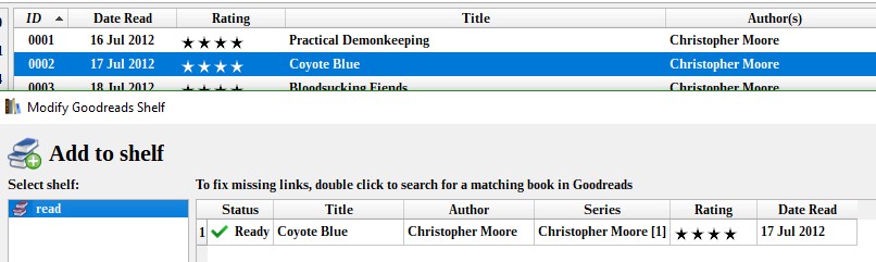

Old 01-31-2018, 04:01 AM   #1092
something random
Member Retired
something random began at the beginning.
Posts: 22
Join Date: Jan 2018
I'm hoping that what Terisa has said is the case and that Goodreads have fixed a problem on their end. But...
As I've said a couple of times recently, this appears to be working for me. I rarely check, but, each time I have checked recently, the date read on Goodreads is set to what I expect. As it works for me, it is very hard for me to find the problem. I need information to do this. I need details of what you are actually doing, and a debug log.
To be actually told what you are doing. Above, you state that you are using the "Add to shelf" function and the "Date read" is not set on Goodreads. You don't say what shelf you are putting the book on. The Date read is only set when the "read" shelf is selected. Is that what you are doing?
It might seem pedantic that I am asking for this level of detail, but I need it. I can't see what you are actually doing, so you have to tell me. And, there have been plenty of times when people say "X isn't working" and when ask, it turns out that they didn't actually do the things need for "X" to work.
The other thing I need is a debug log. Run calibre in debug mode, do the things that aren't working, close calibre and post the contents of the log that is displayed. The log is long and contains lots of information. Usually I can come up with something that is going on from it. Sometimes I can't, so I create a special debug version of the plugin that puts out more details. But, this is the only way I can really see what is happening when the plugin acts.
I only upload my books to Goodreads after I've read them so I only use the "READ" shelf.
I have attached a couple of screenshots and the log requested. I hope this helps resolve or answer this problem.
ID:	161967   Click image for larger version
something random is offline   Reply With Quote

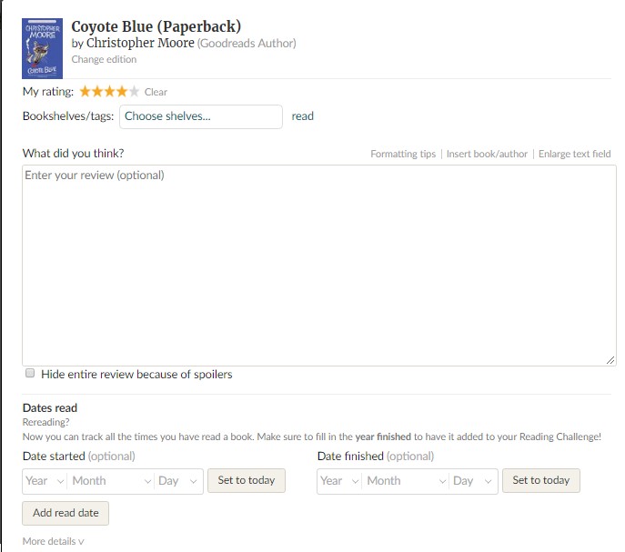

Old 01-31-2018, 08:21 AM   #1093
davidfor
Posts: 24,905
Karma: 47303826
Location: Sydney, Australia
The debug log shows no problems. But, it did lead me to how to reproduce the and what the problem is.
It appears, that if you just add the book directly to the "read" shelf, the date finished will not be accepted. From my testing, if I put the book on the currently-reading shelf and then put it on the read shelf, the date finished is accepted.
I've tried several combinations of shelving and reordering the API calls, but this seems to be it. And it agrees with what I have been seeing. When I start a book, I put it on the currently-reading shelve and the appropriate genre shelves I have. That means that when I do put it on the read shelf, the date read is accepted.
I'll have a bit more of a play, but, if this is how it works, I'm not sure if there is anything I can do. Or anything good. The workarounds I can think of are all a bit ugly and mean a lot of extra API calls.

Old 02-03-2018, 09:03 AM   #1095
smmorris
smmorris began at the beginning.
Posts: 8
Join Date: Sep 2011
Device: Android EVO
Just tested and adding to currently reading and then read resolves the date not showing up problem for me. However, doing that gives me some weird date combinations as the date started is a date after the date read.
I don't use the Currently Reading normally as i will read several (5-6 or more) books before syncing tablet and updating Goodreads.
If it helps here is my method.
Add book to Calibre, update Goodreads to TBR (which does add shelved date.)
Transfer book to tablet (Calibre Companion)
When I select the book to be read in my reading app (Alkido) Calibre Companion marks the book read and fills in the date. This date is not a problem as I normally finish same or next day.
When I sync tablet again my date read is completed in Calibre as part of the syncing process (date as shown in Calibre Companion.)
I mark book read in the Read column (manually created column) fill in rating/review.
I then add to "Read" shelf.
When I look at Goodreads by book status will have changed to read but the date read is not shown. I think the rating also shows up but I don't remember specifically checking.
This may or may not help.
