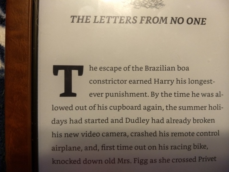

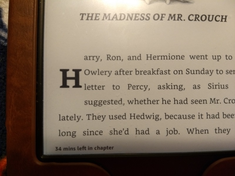

I have pictures because I wouldn't know how to properly describe this.
Basically I have the first 2-3 Harry Potter books straight from Amazon using AZW3. The drop cap at the beginning of the chapters looks perfectly fine. The rest of the series I got in epub format and converted via Calibre to AZW3. The drop cap isn't big enough and doesn't look right. Everything else seems to be fine in the conversions.
I generally use the default options during conversions. Basically, default settings minus unchecking "Remove fake margins" in Structure detection and a check on "Do not add Table of Contents to book" in AZW3 output.
I did try checking "Disable font size rescaling" in Look & Feel as well as selecting "Default Output Profile" in Page setup. Usually I have Paperwhite selected as the output profile.
Any ideas?

Drop caps are not any well defined thing in ebooks. They are implemented using various hacks, and whether they convert well or not depends on many factors. Your best bet is to edit the book after conversion and manually adjust the css used for the dropcaps to get it to look like you want.

I looked at the CSS and yes, altering the values for a class called "drop" allows me to get the look I'd like. I edited one of the non-affected AZW3 files and saw that the values were different. Is there any way to prevent Calibre from touching those values?

The image on the left in your first post looks like it is being rendered with Enhanced Typesetting based on the look of the drop cap and the use of hyphenation. If your PW2 is reasonably up-to-date with firmware and that book was delivered to the device directly from Amazon then it would be in KFX format, not AZW3.
Have you made sure that that book is actually AZW3 format on your kindle?

So just a quick update. I adjusted the font size from 340% to something like 470% so that it looked correct on the edit preview in Calibre's editor. When I transferred, the drop cap looked exactly the same size as the incorrect images above, however the surrounding words were not in a nicely spaced box around it, but looked like they were more loosely arranged around it.
Basically the actual drop cap letter isn't responding to the increased font size, but the surrounding words are spacing around as if it is (if sloppily). So it seems that after conversion, the drop cap reaches a max size and then just shuts down.
It's definitely AZW3 and not KFX. To clarify, it's straight from Amazon, but I downloaded from the website and sideloaded to my kindle. For the most part, I keep my kindle on airplane mode.
