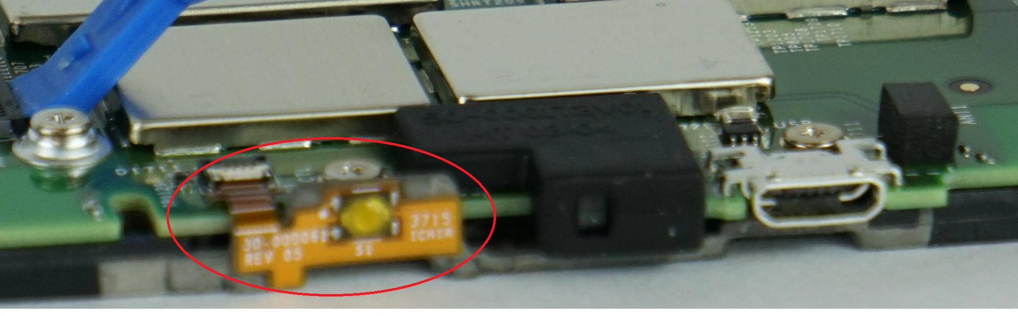

As for #5, I have a need for the power button off of the screen ( see attachment if what I need isn't clear ); the clicky part fell off after manhandling it in an out of the case too many times.
I wonder if you would be willing to part with it for cheap :-)

If you hold down the power button for 20 seconds, does the light flash and the device reboot? It could be the power button is broken on that.
Another way to test, if you have a magnet, you can try to wake the kindle up from the screensaver with the magnet. In the bottom right hand corner of the screen is the sleep/wake magnet sensor.
You can put a magnet on that corner, and then take it away. If everything is working right except the power buttons, that might wake it up.
