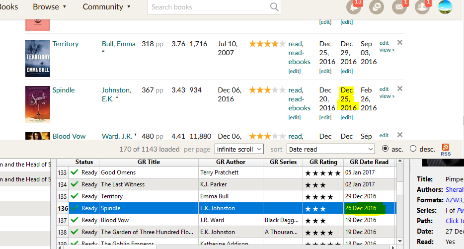

Forgive me if this is a known issue. I'm visually impaired and can't always read exactly what's mentioned in the forum.
When I use the "Goodreads Sync" plugin to upload my books to the website the plugin is picking up the "Date Read" field and for some reason makes it one day earlier. Please see my screenshot.
Sorry again if this is being worked on.
I can see that here, and it is appears to be a time zone issue. It looks like the date being displayed in the dialog is in UTC, rather than the local time zone. If you put the cursor over the date read column, it will show the full timestamp with the time zone. The time part will be less than whatever your timezone is ahead of UTC.
I'll have a look at it in the next few days.
