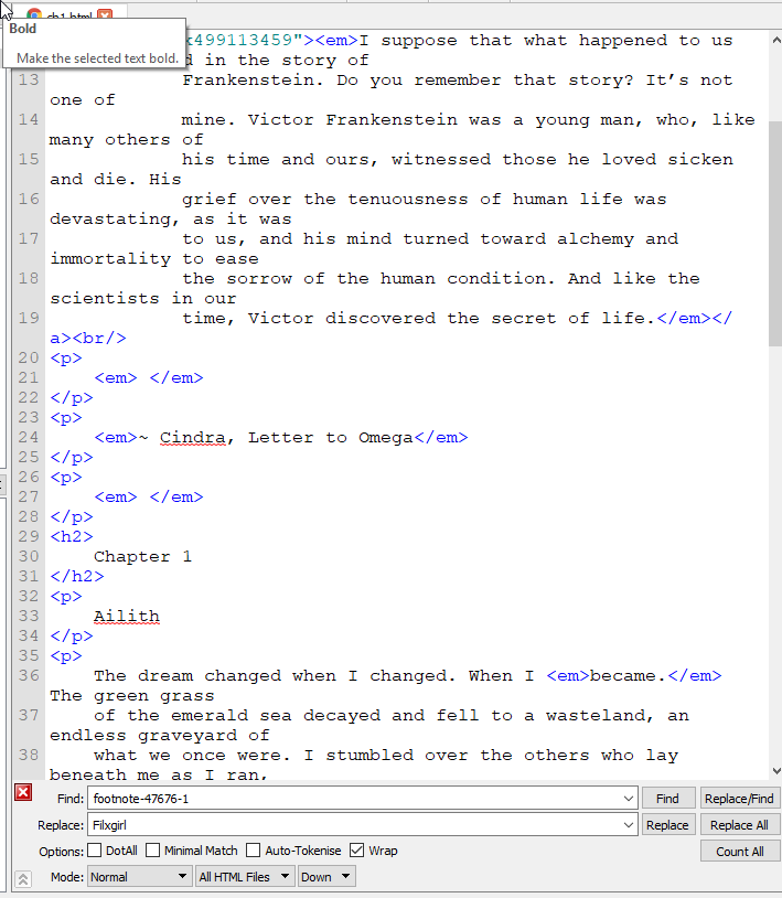

Now, about that "CleanHTML" or whatever that site is--if THAT is the HTML that you get out, run like hell and don't ever look back. That is some of the worst-looking cruft I've seen, if it's to be construed as "clean" HTML. All those bloody spaces, etc. That's not clean. That's the dog's breakfast. I would NOT continue to use those folks, and quite honestly, you should manually clean your first 5+ files, because you will learn loads that you will NOT learn any other way.
And/or you could just not use that crappy word2html site.

Hey, Turts:
You didn't see all the gappy crappy stuff? Like the attached? At first, I wasn't quite sure what caused it; then I realized that there was *something* in there, and whilst I haven't looked at it in the nitty-gritty, they are, at the very least, spaces, if naught else. To me, hinky.
Hitch

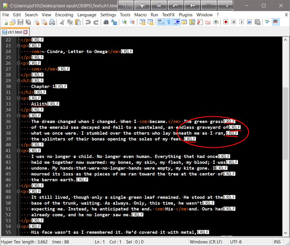

Posts: 22,861
Karma: 34252730
Thanks, Diap. I was starting to think it WAS ME!!! Oh, no...the horror...
Looks like the "Word is just a typewriter" issue to me, with something injecting 4 SPACES after the in-paragraph CRLF endings, maybe Word as a result of a hanging indent on default Normal Style .
That's word2html trying to enforce an 80 (?) character limit.
Same with all the spacing around tags... the person behind that site probably thinks that makes it more readable.

I saw what BR is showing, but without all the 'CR/LF' and '...' that her HTML editor displays. After I used Mend and Prettify it seemed to clean it up except for the <a> issue around the first paragraph and the '<p><em> </em></p>'.
