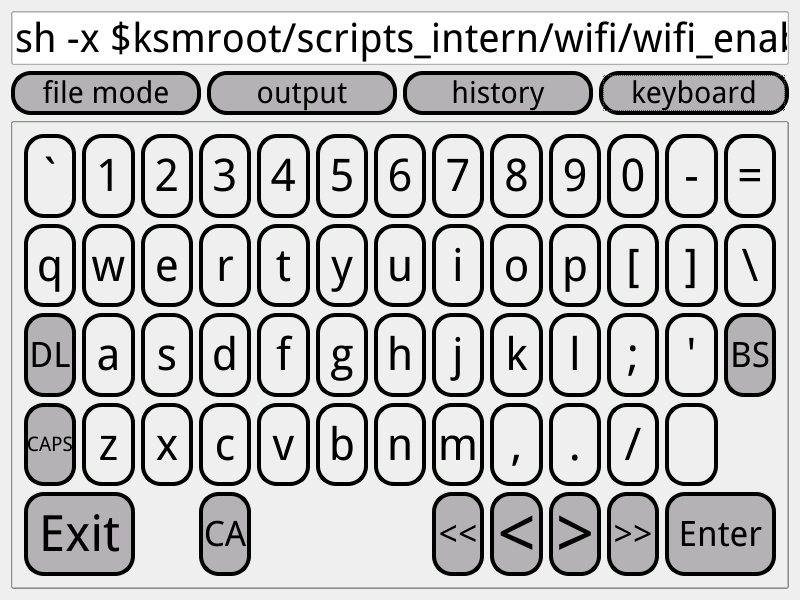

I describe the other approach:
select: "tools" > "start kbterminal.sh"
press on "direct mode" so that it changes to "file mode"
type into the input field: sh -x $ksmroot/scripts_intern/wifi/wifi_enable_dhcp.sh (typing is even more laggy than selecting a menu entry)
press "Enter"
when you are presented with the output view you can page by pressing on the left or right border of the text area, you can zoom in and out by pressing the top or bottom are of the text area. I hope, there will be an error message that is helpful.
You can save the output by selecting "history" > "kbt:save"; and then ""keyboard" > "Enter".
You return to the menu by pressing "Exit" (in the "keyboard" view).

kbt>sh -x $ksmroot/scripts_intern/wifi/wifi_enable_dhcp.sh
stderr:
sh: illegal option -/
finished
This is the result (output).
gaurav_singh_md is offline   Reply With Quote

This does not seem to be helpful.
If you search the Kobo forum, you will find a lot of complaints concerning wifi (on devices with and without modifications). Since we are in the current situation unable to find the specific source of the problem, I would recommend that you re-install the firmware (see here). When installing it, select "install partial update" (not "install update"). If wifi still does not work, install the firmware that you had before the last update.
