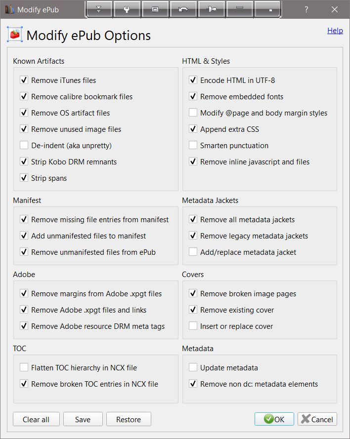

Don't use spaces in eBook filenames. Also use Modify ePub to do some cleaning up. Then the rest of the cleaning up do it in the Calibre editor. Also install the epubcheck plugin to validate your ePub.

I installed Modify ePub, but there are many options that I do not really understand, I do not want to mess up my library.. The idea is to keep only the data I need (title, author, publication date, tag). I guess I can use "Remove all metadata jackets", "Update metadata" and "Remove non dc: metadata elements"?

Quality check seems interesting to make large checks, thank you! I have been using Modify ePub since JSWolf suggested it to me but I'm not very sure about options to use. The closest solution to what I am looking for is in Sigil's metadata editor, but I have the impression that it only works for one book at a time.

Here the settings I have for the Modify plugin.
