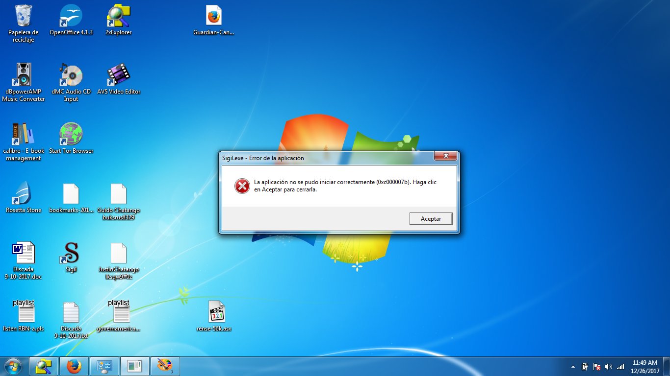

I wish I could say that the installation was flawless, but unfortunately my little laptop is giving me fits. Just as I had experienced with 0.98, got an error message saying I was missing VC Runtime (don't remember the exact message). I installed that, then got another message, dealt with that, now I'm stuck with the error below. I went here and followed all their directions, no love.
So I'm back to 0.9.7 on my laptop.
And it was with some trepidation that I dragged the file back to my black box, even though it's been sitting on 0.9.8 for quite a while. But, I installed 0.9.9 there, and it ran flawlessly. Whatever I did to that box when I had the problem with FlightCrew, I haven't done to the little laptop. I'll figure it out sometime--maybe!--and if I discover the shortage, I'll let you know here..
So once again, I've got some difference between my two computers that permits me to run 0.9.9 on one, but not on the other. >>sigh!<< I hate Windows!

The correct VC runtime comes with the Sigil installer, though. There should be no need to install it separately.

Okay, I promised that I would come back and report if I found a solution, but I had to wait until my forehead healed from the repeated beating it has taken. Also had to replace my keyboard, too, because somehow the "N" key became embedded in the above-mentioned forehead.
I can now say with au-thor-a-teh that that is the error message you receive when you try to install the "standard" version of Sigil on a Lenovo laptop running the 64-bit version of Windows. I can also state with that same authority that is not the message you receive on a (or at least my) custom box with the Asus chip-set running (ahem!) the exact same version of Windows. I can say with no authority why that would be.
However, now that this N00B has installed the x64 version of Sigil on that laptop, it is running as smoothly as silk.
