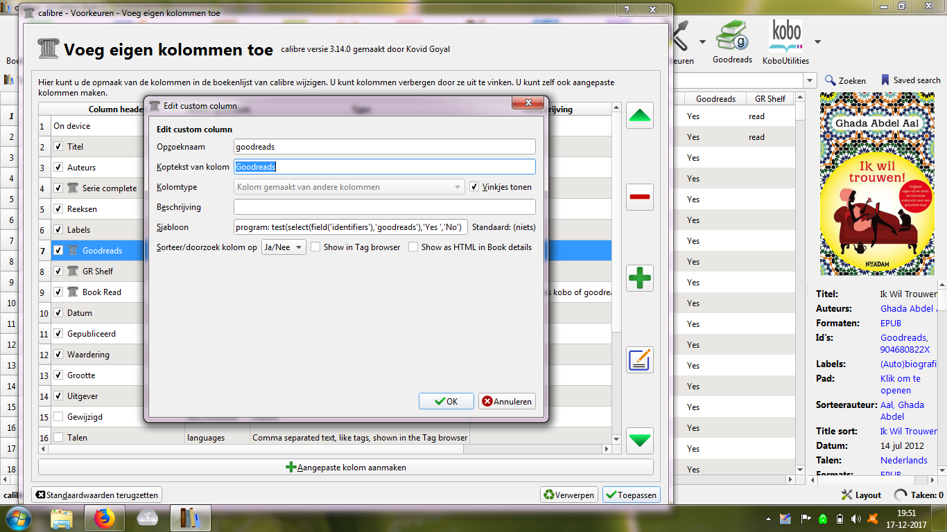

I use the goodreads plugin and it works great with Calibre.
Yesterday I had some trouble with my SD card so I had to reset everything and install Calibre portable again.
Now I have lost the checkmarks and it only shows Yes/No instead of the checkmarks.
Can somebody help me (and yes I am a noob)?
I will try to explain what I did (also see the print screen):
- Made an custom column named "goodreads" from the type build from other columns
- checked the box for showing checkmarks
- in template I have: program: test(select(field('identifiers'),'goodreads'),'Yes ','No')
- sorting is set on Yes/No
Hope this is clear enough and somebody can help me.
Thanks in advance.

Try to use only {identifiers:select(goodreads)} as template.
with the checkmarks box checked it should work

Thank you very much ! It has worked and now my checkmarks are back, so much easier to see which ones aren't connected yet.
So thanks (again)!
