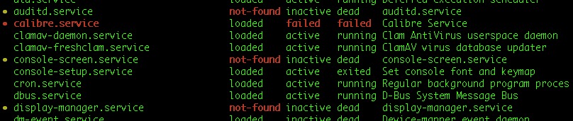

Thanks gentlemen for sticking with this. I'm a Linux noob getting lost with the requirements of this installation. So to start from scratch, I did an uninstall.
sudo /usr/bin/calibre-uninstall
And then installed calibre 3.13.0 from the download section. Since this is a Ubuntu 17.04 headless server with no GUI, I did ignore the desktop warnings.
Next:
calibredb --library-path=/srv/sharestorage2/CalibreLibrary
calibre-server
   (returned)
   calibre server listening on 0.0.0.0:8080
   OPDS feeds advertised via BonJour at: 192.168.1.21 port: 8080
sudo systemctl enable calibre.service
Network access to the database from several devices seems to be working. Apparently /opds is also working as it should. I think BonJour may have been the key and wonder if that capability was not included in the older version calibre-server I was attempting to use before.
One remaining concern is the leftovers from the full calibre install, including the failed calibre.service. Is there a way to avoid this (see attachment) and remove the excess?

You need to uninstall the distribution provided calibre, which you do by using the software management tools of the distribution, apt for debian/unbunut, yum for fedora, pacman for arch, etc.

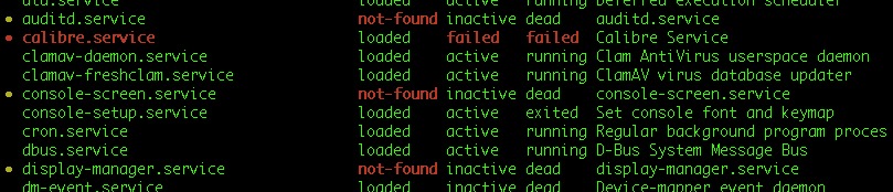

Several services were not-found (inactive) and calibre.service loaded but failed. However all the calibre-server functions were working including access to the /opds xml file.
I then added a @reboot crontab function as a simple way to automatically start calibre-server by adding this line at end of the default crontab file:
 @reboot /opt/calibre/calibre-server &
Attempts to convert calibre-server to a service weren't successful. Probably due to the conflict with the existing calibre.service.
It is a little disconcerting having those failed or inactive services hanging around from the GUI version of calibre. Any way to remove them (see attached screenshot)? While a CLI version of calibre would be appreciated, I'm happy having everything working this way.

calibre does not install any service files. Either you installed them yourself or the distro calibre package did it for you and failed to remove it. And a bit of googling will show you how to remove service files from your system.

I'm a confused noob. Doesn't the installation from https://calibre-ebook.com/download_linux using the Binary Install command install calibre.service? Even though its GUI functions cannot be used.
After my uninstallation using the Ubuntu apt-get and a reboot, all signs of calibre and the calibre.service were gone. The only subsequent installation I made was that Binary Install command.

No the binary installation does not install service files. Easy to check, the installer is here: https://github.com/kovidgoyal/calibr...libre/linux.py
Just search for the word service in that file.

I deactivated the errant calibre.service with:
sudo systemctl disable calibre-server.service
Then deleted the files, rebooted, and calibre-server continued working like a charm.
The bottom line is another source led to my problem. Not Calibre or Calibre Companion. Making sure of a clean foundation before installing something new sure avoids problems! As does learning a little about services and systemctl.
