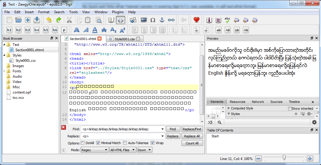

Have a look at the attached epub test file. I embedded your font, created a stylesheet and assigned your font as the body font. Then I picked some comment in what I beleive is Burmese from some website and put it in the body of the xhtml file. Looks Ok in Preview and Book View, but not in Code View...

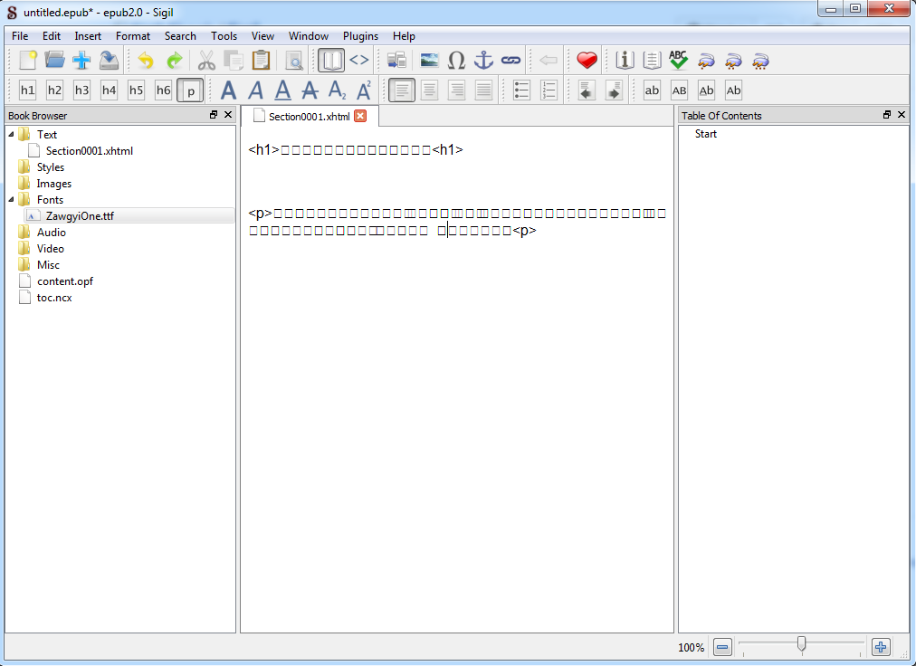

Preview and Book View Ok - see attachment

Code View - the squares....

Download the ePub in post #7... The screenshots are from that file.

You control the font used in Codeview by Sigil Preferences. Make sure you are using a font in Codeview that supports the unicode ranges/characters you want to see and is fixed size like Courier.
I tried to change the code view font in the Preferences, but this font was not listed. Maybe it is not fixed size, I don't know.
