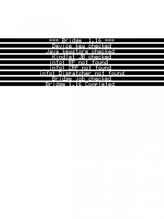

Meanwhile, back on topic:
The new jail break bridge code (that auto re-installs the jail break after an update) for all touchscreen devices K5 ... KOA2 is almost ready (I still need to check screen printing on KOA2).
KT-5.3.7.3:
That should also cut down on the number of: "But I am not sure if the bridge code ran" type of posts.
Next: New dispatcher script (so ;log xxx yyy zzz will work for add-ins even if nothing else will).
