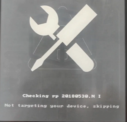

Old 10-04-2022, 05:46 AM   #118
Lorand
Lorand began at the beginning.
Posts: 9
Join Date: Sep 2022
Device: kindle pw5
Gives an error when installing, can anyone help?
Lorand is offline   Reply With Quote
Old 10-04-2022, 12:35 PM   #119
NiLuJe
BLAM!
NiLuJe's Avatar
Posts: 13,506
Karma: 26047202
Location: Paris, France
@Lorand: Read the error message. RP/CRP supports stopped a few devices ago.
Old 10-05-2022, 03:00 AM   #120
Lorand
Posts: 9
Join Date: Sep 2022
Device: kindle pw5
@NiLuJe Thank you for your answer. Yeah, I read the message but I didn't know why it was I read everywhere that you should install rp&crp as a precaution. Is there a similar extension for pw5?
